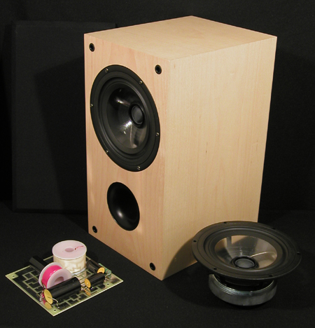

Thanks for the interest in the HT6 as a option .
But as noted for rears I would stay away from such a large speaker as the Kit 61 or the HT6
Why.
Well even in 6 channel format when you use a sub via a reciever the cut off freqency is normally around 80-100 hz.For this reason alone I would lean to a smaller rear speaker.
Now if you had a large room 20 ft wide running 100+ watts into the rears and had room to position them I would lean to the MTM for rears.
Now coming to the point of positioning them.
I helped Danny of GR in the design of the AV1RS this rear speaker fires up and uses the ceiling as a reflection to have a better time alignment in any room if used as rears or as side surrounds.
Click the image to open in full size.
I would even use a sealed rear speaker tilted back and upward.Far better time alignment to the seated location for surrounds.
Well just my advice.
Enjoy
  Reply With Quote
