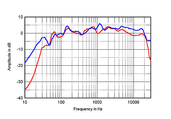

Red line, in-room response at Atkinson's room

If the BSC of LS50 is ok, how can Atkinson's in-room measurement be so lean on bass and even midrange? We must compare it to his other measurements. The inter-relation of his combined near-farfield vs. in-room.
