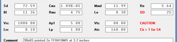

This is what I used for the 4" Celestion sealed back mid:
This worked pretty well. BTW, the thing about getting the mid ports "as close as possible" to the throat is for when you're using a small HF compression driver that has trouble reaching down to 1kHz. If you use something like a DNA360 or a DE250, you have some leeway to put the ports out further. But usually the best place to start is with the ports down as close as the driver sizes and mounting requirements will allow you to go, you can always move them out. Try to adjust the midrange for best response, but also so that it has the least response at frequencies above the cancellation notch -- get the acoustic filter working for you instead of leaving an ugly glitch that has to be removed with the crossover.

I mean: sqroot( (2.5 / 4) / pi ) *2 = 2.8mm Diameter per port ?!
Is this realistic?! Compression ratio of 29.036 seems pretty deadly to me...
Everything else I tried resulted in a bad response.
If this isn't realistic, what tips do you have to get a smooth response in this case?

AP1 is in sq. cm.
2.8 cm is more reasonable but on the large size for a mid that covers 300 Hz++. shorten the Lp by thinning out the horn wall around the ports, creating frustrums, for shorter effective port length and you should find smaller diameter holes work

I think my mistake was, that I thought AP1 is the sum of both drivers which doesn't seem to be the case... One hole is 1,26cm now.
Just to clarify - Ap1 is the total area for both drivers.
If Ap1 = 2.5 cm^2 then for each driver the throat chamber port area is 2.5 / 2 = 1.25 cm^2, the radius is (1.25 / Pi) ^ 0.5 = 0.63 cm and the diameter is 0.63 * 2 = 1.26 cm.
The value of 1000 litres specified for Vrc seems very large (equivalent to a cube having a side length of 1 metre).
The two-way Unity horn should really be modelled as a multiple entry horn system, rather than as an offset driver horn system, so that the high frequency driver at the apex throat is also taken into account.

David -- the huge value for Vrc is because this is a sealed back driver, it's compliance is already determined by its built-in sealed back in its measurements. I made Vrc large because I didn't want that compliance reduced further by another back volume (that would really have no effect since the compliance is as low as it will ever be).
Is that not the right way to do that?
Hi Bill,
For your design, what you did makes complete sense.
I did not realise that MrOIL also intended using sealed-back drivers :).
Kind regards,
David
