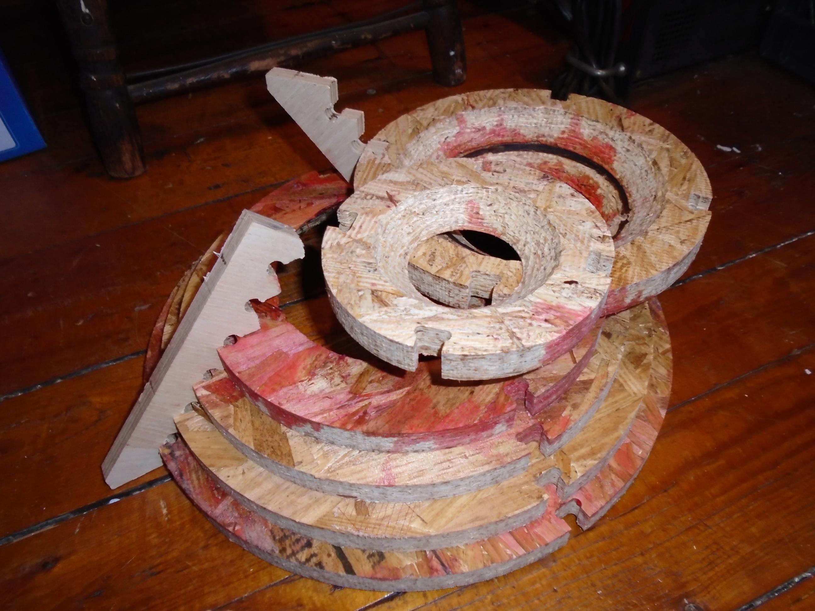

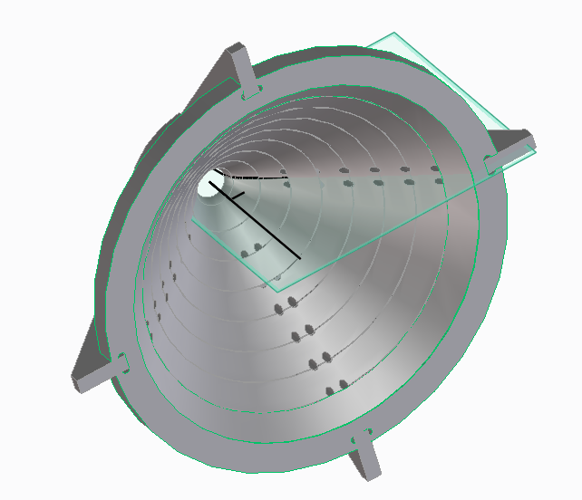

he seems to have stopped making kits and waveguides but if you really have the tools and aren't counting labor then even the OS waveguides can be made
the waveguide geometry is simple to model, I did a rough practice cut on a ShopBot a few years ago
his preferred Urethane modeling board material can be worked with woodshop tools with the right blades
it even looks like you could send out to a 3d printing service for FDM ABS or PLA waveguide fabrication and stay within your budget
