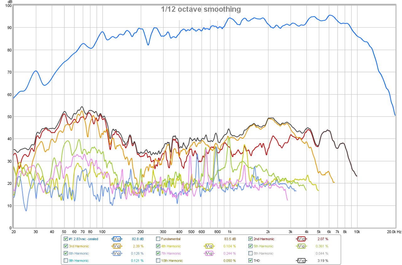

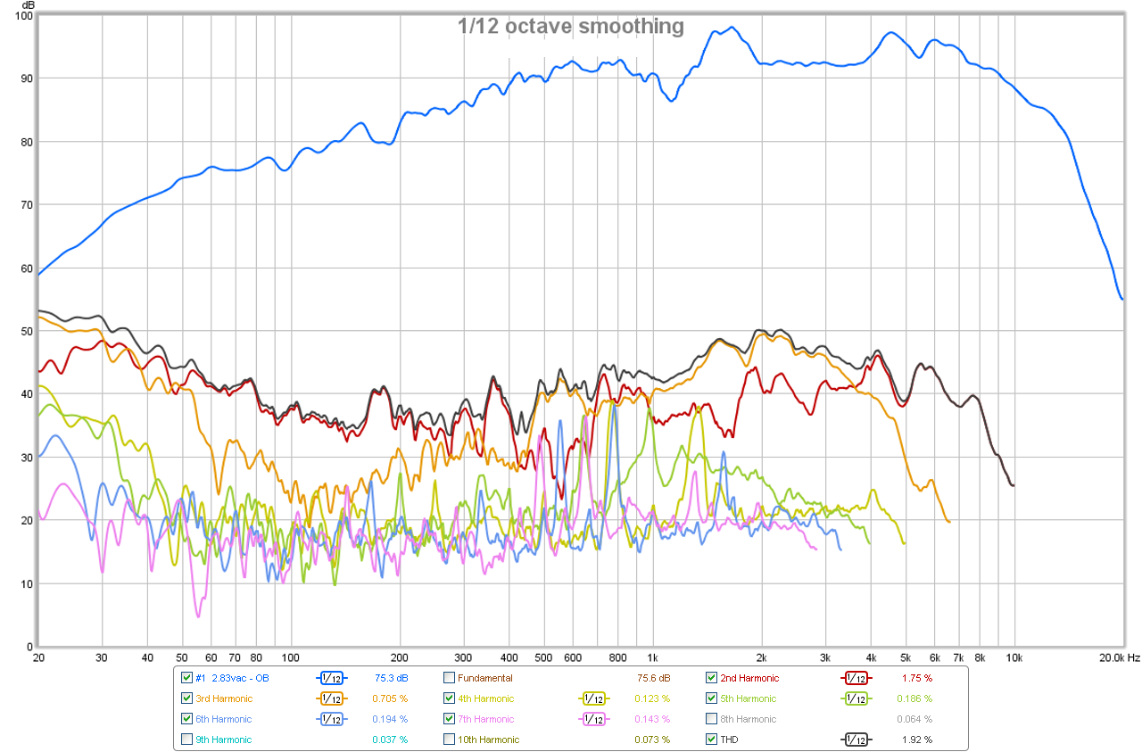

The driver was the AC130F1 and perhaps I used it in a bit too small of a cabinet at 5.7 liters, but here is what I mean by increased HD when sealed vs OB.
The cabinet was a recycled Boston HD5 which happens to be a "drop in" fit for the AC130F1. I had a good size wad of factory polyfill from Boston inside (not shown in photo below). More info in this thread:

Here is the OB and sealed data at same 2.83v drive level:
OB case:
Notice the broad HD peak centered at 60Hz for sealed case:

Is that from the sealed enclosure, the LT or one of the two defective drivers you received in your order?
Since the system is first order and the the FR58 is not in a seperate chamber, there's not much inference to make as to %THD of the woofer only.
To blame the rise in HD on a sealed alignment is nothing more than a shot in the dark with a crooked barrel.
Your measurements in this particular case are suspect........and asking 50hz response from a 5 inch woofer isn't useful data either way.
That is from one of the two defective drivers - they exhibited the same problem. The "good driver" had about 1% HD vs 3% HD at 60Hz. The data was taken with the driver connected to an amp with no miniDSP and running full range. So no LT involved - just native response in sealed vs OB.

In order to compare the two distortion measurements of OB vs sealed the OB needs to be to EQ'd to roughly the same target as the sealed.
As the OB version drops steadily in output from 600Hz down and is producing a significantly lower output it is not a fair comparison to judge the HD produced.
The measurements look good to me but is a little bit of an apples and pears comparison. If you could EQ the OB to have a similar output then this would be a very good way to compare the same driver in OB vs sealed.
I don't know how REW works out the distortion percentages but the sealed actually looks to be lower than the OB when compared to the fundamental particularly from 50Hz down.

Agreed. One problem with the sealed alignment that doesn't really exist for other alignments, especially with EQ (or LT) is very high pressures. A small sealed box can easily have inside pressures 30 dB above the outside pressures which causes a lot of stress on the cone and produce a lot of force on the enclosure that need to be handled.
I also agree with fluid that the response needs to be EQd to compare. Another thing that makes it difficult is that the higher directivity of the OB will reduce reflections and it will therefore sound cleaner.

I disagree that the OB has to be EQ'd to see effect. OB already has more excursion than sealed because of lack of air spring. Normally, lower excursion means lower HD. To EQ the OB to move more is actually the wrong way. If anything I want to compare HD for same stroke. I am not comparing performance of bass capability of OB vs sealed to see what HD is. I am looking for why HD would rise for a system that moves less.
As you have found, stuffing does not affect distortion directly.
Fiberglass or foam won't damp low frequency sound waves, the material is typically used in sealed cabinets to increase the apparent box volume by 15-18% by adding isothermal mass, which lowers the Fcb (closed box resonant frequency).
The HD rises because the sealed driver is doing more work- around 10 dB more SPL is being produced just above the frequency where you noted the rise in HD. Increase the voltage in the open baffle driver to achieve that level and it's distortion level will also rise accordingly, and would likely be considerably higher than the sealed.
When comparing distortion levels between the same driver in bass reflex and tapped horns, the TH had about 6 dB more SPL for a given voltage, and had lower distortion levels than the BR. However, the TH had more distortion for a given excursion than the BR, like your sealed vs OB example, distortion is work related, not just excursion related.
This is why I asked for examples at the same SPL level (not voltage) with the sealed driver compared to an open baffle.
You could see the difference in the work the driver is doing to by looking at the impedance curve, the impedance peak in the box has been driven up from it's Fs (35 Hz free air resonance) to above the frequency region of the rising distortion level. Below Fcb, the distortion level remains constant (the small box limiting excursion), while the OB distortion rises.

So you are saying its normal to see 3% to 10% HD below 100Hz in sealed bass boxes? Bushmeister obviously was able to achieve a much lower figure of under 1% at 100dB.
3% to 10% (or more) HD below 100Hz in any type of enclosure is "normal", depending on SPL, distance and boundaries.
Obviously, Bushmeister's larger box with two larger drivers does have lower distortion than a smaller box with one smaller driver at a given level.
Hoffman's iron law at work: low, loud, small, pick two. You can't expect much clean bass from a pint sized box.
