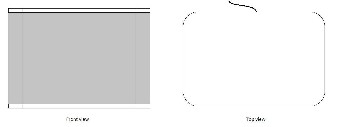

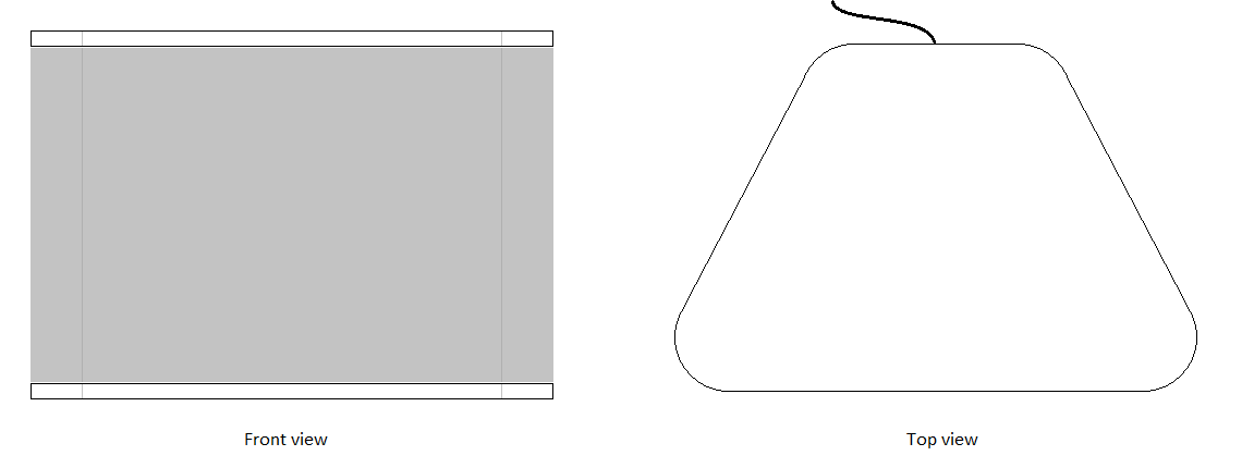

First: Appearance.
This is how my media console looks like:
I would put them atop of that. I feel like the design is hard to make slim (width) as you need to be able to fit a quite large COTS WG, so why not make it just that: Wide and low. Maybe something like this:
Sketches (Width: 480 mm/18.9", height: 330 mm/13", depth: 320 mm/12.6"):
Top and bottom are either high gloss white/black or solid oak. Front/sides/back is covered by one piece of fabric, maybe something like this:
Should be fairly easy to make. Inside: a XT1464 coupled to a SB65, I like the constant directivity aproach more than the tractrix kind. I would however not make it sealed, but have about 1 Sd of holes on each side to reach cardiod/supercardiod behavior.
They need to be aimed slightly up as the console is quite low. I'll need to try a few kinds of short legs.
Now to my question: I have 4 of the Faital Pro 8FE200-8, would these work? X: care to sim them in akabak? I don't need to go very low as the media console contains one subwoofer in each end.
/Anton

Onni,
Nice concepts. If you look at the aspect ratio of my horn, with enclosure and in horiz orientation it can probably work for your shelf. 17in wide x 11in high x 13in deep. I never thought of grille cloth. But I imagine if you covered this compact horn with grille cloth it would look like an ordinary speaker with performance that astounds and surprises people.

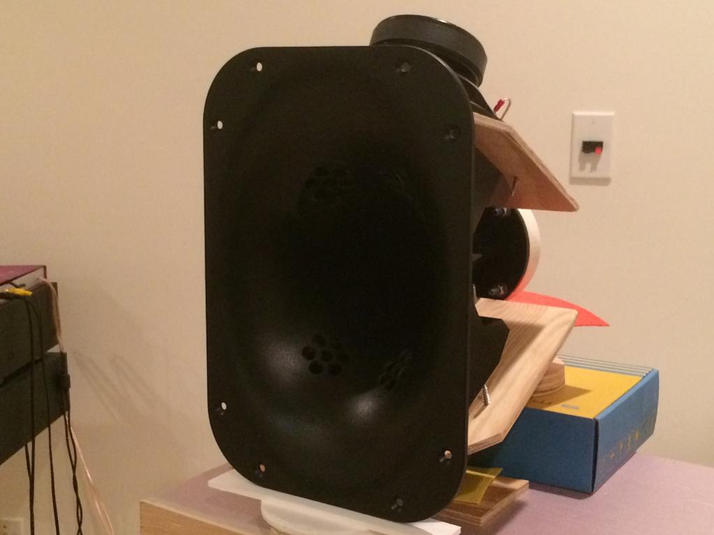

Imagine a box tightly conforming around this:
529143d1454556747-bookshelf-multi-way-point-source-horn-lth142-second-woofer-04-listening.jpg
Top view if horizontal orientation:
Seems to be a good choice for this aesthetic:

Exactly my thought! I showed my wife a few horns and apparently they don't have a place in our home 😉 But if covered with some kind of fabric it should be fine 🙂
/Anton

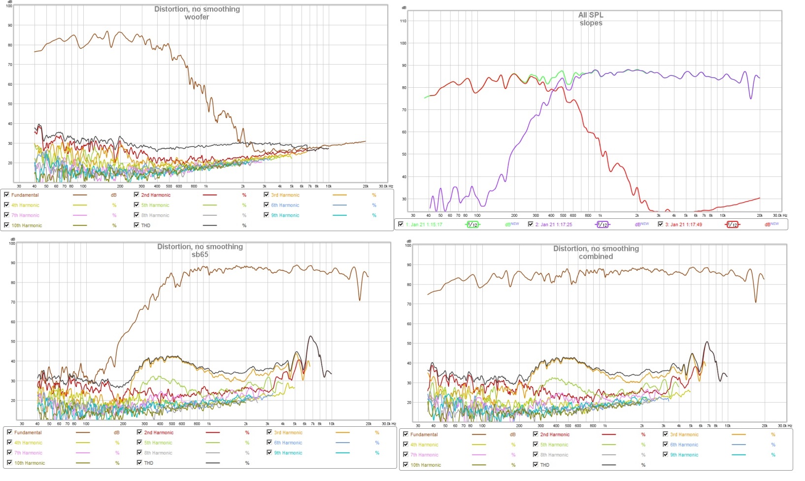

Here is my new 100dB distortion with sorbothane gasket on baffle - improved the HD even more.
The box still needs stuffing which may improve things further...
PS - Xrk - I think you were right about the SB65 - I loosened off the screw a little and HD improved a lot - just over-tightened things I think.

You are right X, on looking back at that 7khz peak, I don't think it is the room. I will have an experiment.
Regarding bass distortion, that is without a front baffle gasket, or stuffing. I need to go buy some rockwool
100dB at 1 meter and you are getting better than -40dB HD at 30Hz! Amazing - no sub needed, really. 😀
Glad that my suspicion of a distorted frame on the SB65 was the source of the high HD at 2k-7k! 🙂
That 7k peak went down to -55dB!
But now there is the -45dB peak at 5.5k - still not a bad at all.
This speaker's HD performance is actually, very far beyond what I would have expected. With the rock wool,it will maybe hit -45dB at 30Hz? For a speaker to have a range from 30Hz to 20kHz with a two way sealed, quasi transient perfect, near flat phase, low HD, is excellent.
Actually, what is the -3dB and -6dB point for the bass? What is the voltage drive level required to get 100dB at 30Hz? Can you show a measured electro-acoustic XO plot like this one (upper right graph) you did earlier?

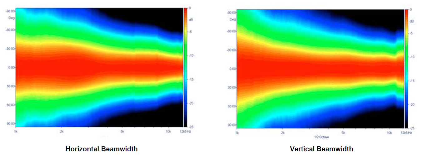

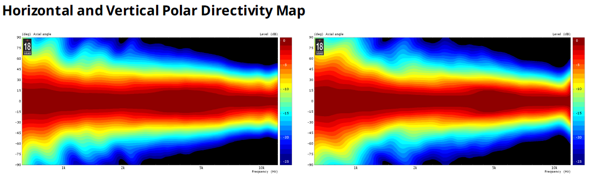

These waveguides are different than a SEOS, which aim for a flat DI over as wide a range as possible. So you are not going to do any better than the factory pristine (undrilled) waveguide. Fortunately, both 18Sound and Faital Prog provide the polar DI maps for their waveguides used by Bushemeister and myself, respectively.
18Sound XT1464 (elliptical):
Faital Pro LTH142 (tractrix):
vs. Gedlee Summa:

Here you go X:
Would it not still be worthwhile to have a high resolution polar map of the completed speakers in the database? For science!
