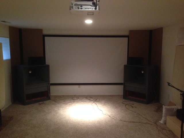

John completed the build and the arrays are playing music. They occupy very little space, can go plenty loud, are pretty efficient and very low distortion (each driver is barely moving even at loud levels). Using a single 3.5” driver ensures a uniform off-axis response up to a high frequency, above which the Vifa does start to beam, but it is relatively well controlled. The on-axis response is flattened using DRC software, i.e., automatic room correction. The final result is quite good. Measurements coming up shortly. There is still a long way to go. The EQ is doing a pretty good job, but I think it can be better.

By the way, did I say how jealous I am you got to listen to both Pano's Altec setup and Bill's Cosines?
Ra7 does get around. 🙂
He just missed hearing my mysterious Hawaii lava cave system, I had not yet moved in there when he visited Kona. I regret that, because that "room" taught me more than any other about playback acoustics. Wish he could have heard it Surprising!
I would love to hear Bill's unity horns. I've heard all of the Danely products at least once, and the SH50 two or three times. It's a delight. Would be very intrigued to hear what Bill has done with it in a home version.
Of course those corner arrays are something special. I like and don't like line arrays, want to hear if Ra7 has made a better mousetrap. :up:
Awww, that's too bad! I really wanted to visit the lava cave room. You must be the only audiophile to have ever had a lava cave for a listening room. Now that is pretty cool!
I'm sure my room and setup can be improved, Pano is an expert in setting it up in an optimal way. I haven't really paid much attention towards optimizing it. Wesayso was helping me identify some problematic reflections and get a clean first 20 ms. I might still pursue that this winter. But it sounds so good anyway that it is tempting to sit back, relax and just listen.

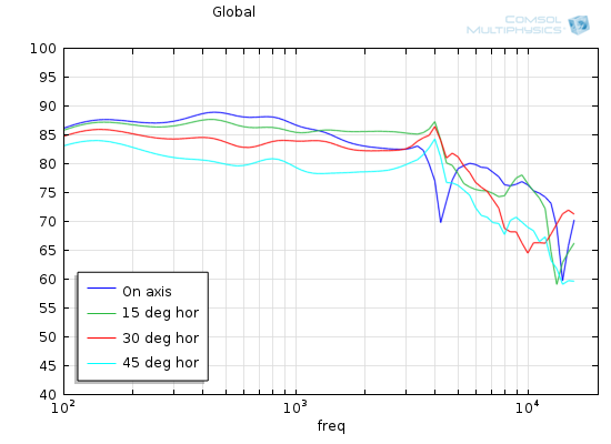

I'm trying to simulate corner line arrays to be able to design a waveguide. Your speakers are the ones that look most like what I'm planning, so I have some questions:
Whats the width of the baffle (looks like 20-25 cm)? What's the CTC-distance for the speakers (looks like 84 mm)?
Do you have any measurements at other horisontal angles? How much off-axis are you in the sweet spot (measuring point)? 15 degrees?
/Anton

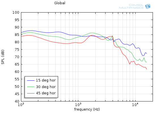

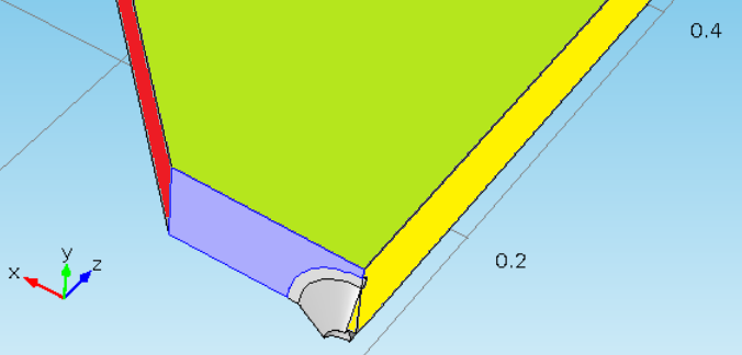

I did a sim with a 20 cm wide baffle and an approximated geometry for the TC9. It looks like this:
Blue is baffle, red is wall, yellow is centre symmetry, grey is driver membrane and green is vertical symmetry.
I'm assuming that
- the line array keeps its 84 mm ctc distance all the way to the floor and ceiling
- the membrane keeps a pistonic motion from 100 Hz to 16 kHz.
- walls are rigid
- the corner is infinitely deep (no other walls, infinite room). Equals a gated measurement before first reflection.
This is the resulting frequency response in the far-field at 15, 30 and 45 degrees off axis:
Not bad, especially the 15 degree curve.

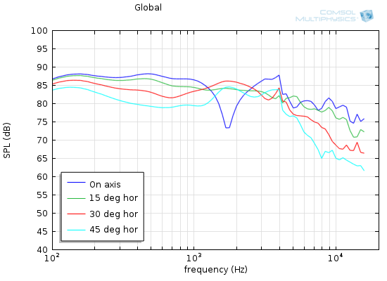

Here is one with on-axis response as well:
Here we see that the on-axis response has a dip at 1700 Hz. I'm assuming this is due to the discontinuity when the baffle meets the wall. Half wavelength for 1700 Hz is 0.1 m, which is identical to half baffle width.
I'll be at least close to on-axis with my line arrays when sitting at the outer positions in the couch. I take it that you are far enough back in the room to avoid this?
/Anton

Wow, excellent sims. I'm having trouble understanding your first diagram, but the sims look believable. Like I said, I did not measure off-axis horizontally. I am far enough back that I sit at about 15 degrees off-axis.
I did have problems with the baffle to wall interface and there were some reflections from it. I solved most of it by adding a thin piece of cardboard to make a sort of waveguide that went from the driver to the wall. This helped get rid of some of the reflections. Although my solution was temporary at the time, it has stayed in place for over a year, mostly because I haven't had time to look into it.
You might want to push the drivers as far back inside the corner as possible so that the frequency where you get the dip gets pushed higher. I tried hard to correlate the dip to the baffle width but I recall that it did not match.

What about the sim is hard to understand. The geometry?
Do you have photos of the cardboard? Did you add it to both sides? Making the baffle asymmetrical is almost always a good idea to reduce diffraction issues. Are they visible in this photo?
In that case you did something that strongly resembles my plan 🙂

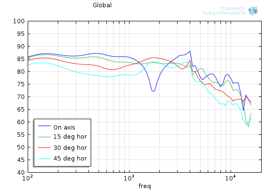

The addition of the cardboard waveguide essentially reduces the width of the baffle to ~76 mm. I made a simulation of that:
The reponse below 3 kHz is greatly improved compared to a 200 mm wide baffle:
607175d1490271230-corner-floor-ceiling-line-array-using-vifa-tc9-ra7-no-waveguide-200-mm.png
(I remade this sim with a more detailed geometry for the TC9).
It makes the first dip narrower and at a higher frequency, which should sound better. Moving the dip even higher in frequency is probably preferable if you want to listen on-axis. That might be possible to achieve by rear-mounting the drivers and adding a separate waveguide to each driver.
/Anton
