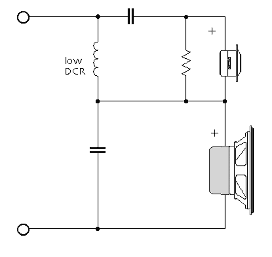

Started this build over the weekend, a bit rough and ready. Building the crossover atm
Being similar to the full range 12P I thought the 12PW with its shallow cone cd be ok crossed around 3khz to the viawave(inspite of being a 7" driver).
The crossover is 1st on the woofers and 2nd on the tweeters with an l pad. I'm sure the values are not really correct but will build and measure etc
The cab design is a very simple tapered TL with a line length of 175cm, will start cutting the sections out tonight.
If anyone want to critique the crappy crossover schematic, pls do..

Slowly but surely. Out of the cabs the sound of the two drivers together is promising. Very smooth and detailed. I need to reduce the attenuation on the Viawave by about 1-1.5db and the coil on the Alpair is rolling off too early I think.

Hi Bill,
Good to know that initial impressions are positive.
How high are you crossing the Viawave ribbons?

Confess the X/O is not properly sim'd so a lot of guesswork.
Cabs, was hard to decide between mltl, TL or a DCR.
I went for a TL as it looked like the easier option, assembly wise

I have 4 A12pWeN & a set of CSS RT1 ribbons looking for a project -- i was thinking of mating together.

I'll get Scott to do something and was also thinking of trying the same topology as in this thot experiment:
