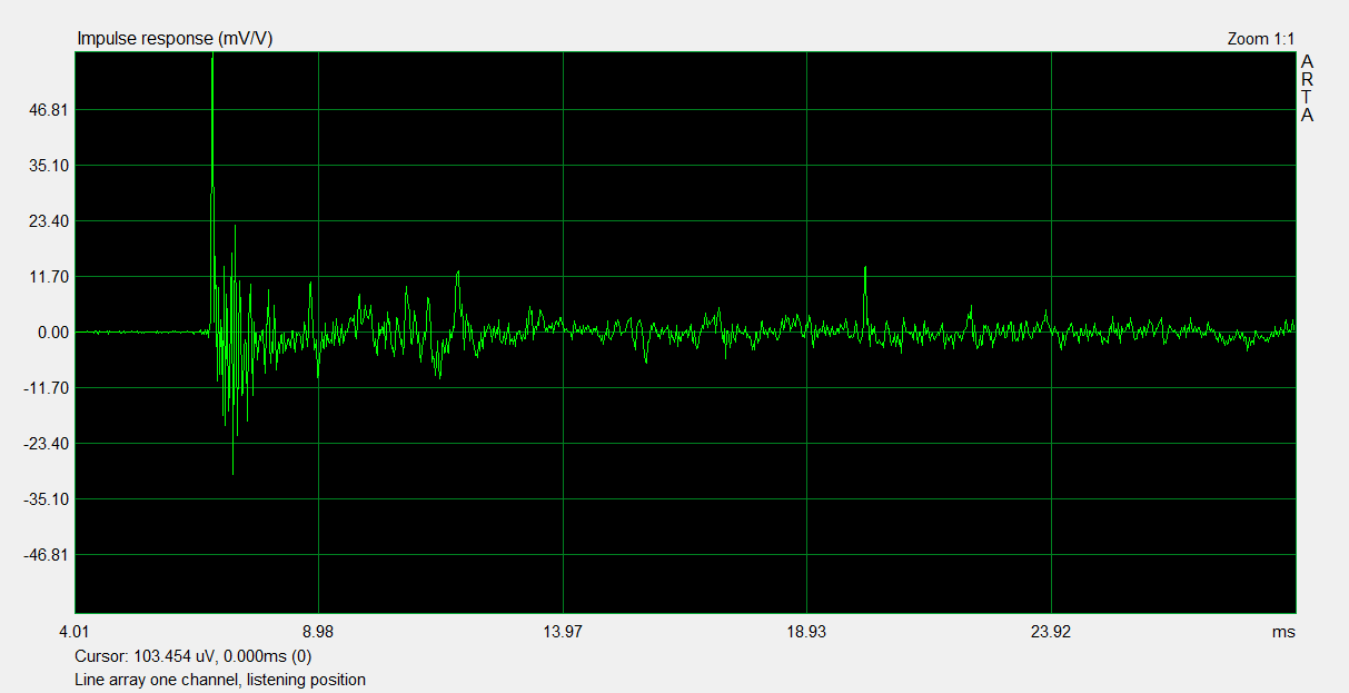

You are right of course, I accidentally posted the step response instead of the impulse response. The impulse response of your simulation looks very similar to the step response of my arrays.
This is the in-room impulse response of my line-arrays:

Very! Thank you very much. I'm assuming the smeared impulse response of my line-arrays is caused by real-world limitations such as non-infinitesimal driver spacing and a not perfectly reflecting floor and ceiling. Do you agree?
