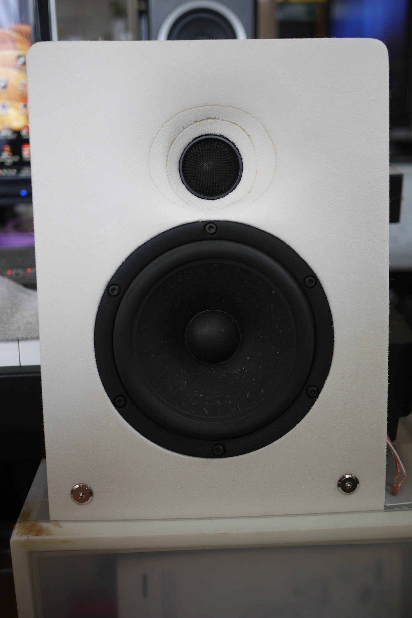

Satori MW16P-4.
Dayton Audio RS28F-4 1-1/8" Silk Dome Tweeter
These are the same exact drivers being used by Jeshi in her EVA foam monitors. They seem to be a great match. More info here:

With the Satori, I would argue you don't really have that problem (wanting greater clarity and dispersion than their woofer or mid-bass provides).
At least in my experience, the Satori MW16P-4 can still benefit from the higher level of resolution obtainable by crossing over to a suitable tweeter (or tweeter-and-waveguide combination) at a frequency of around 1~1.2kHz.
