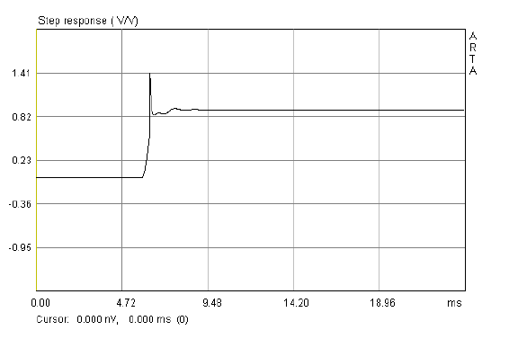

Here is an example of the XO plot from the Harsch paper:
Here is the step function from the above XO as predicted by Harsch:

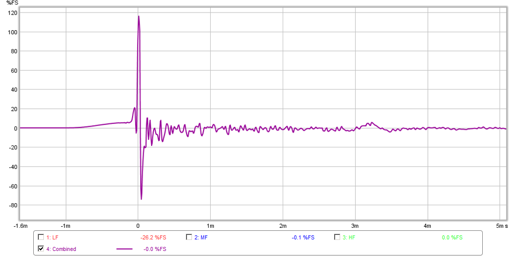

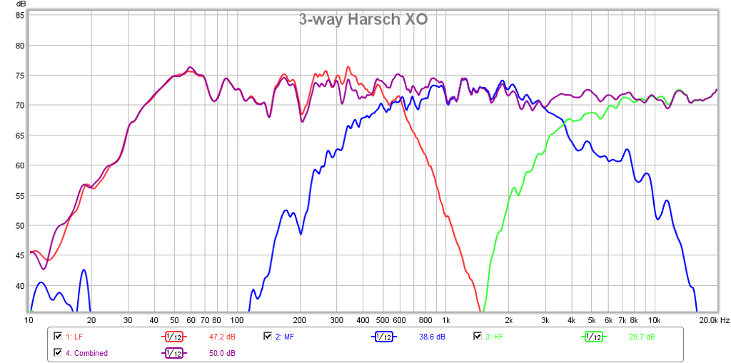

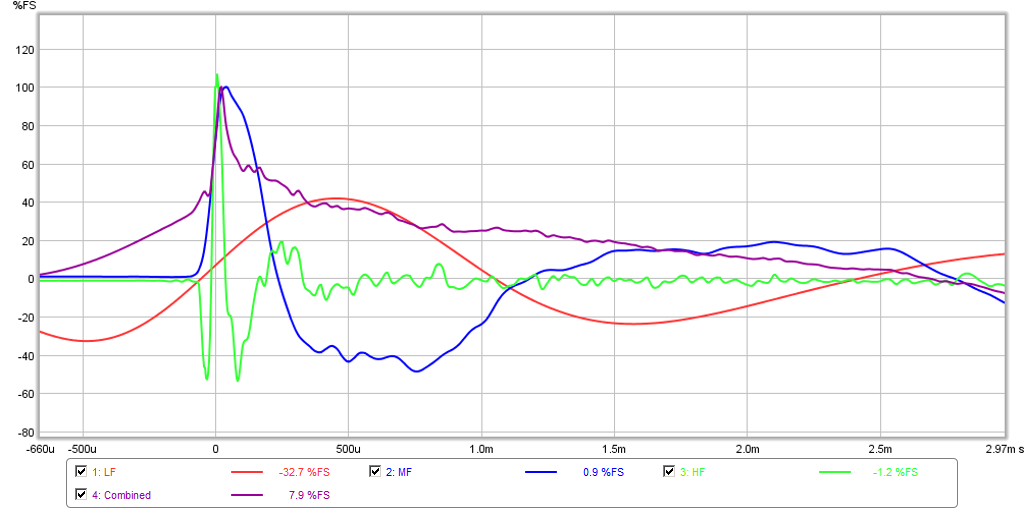

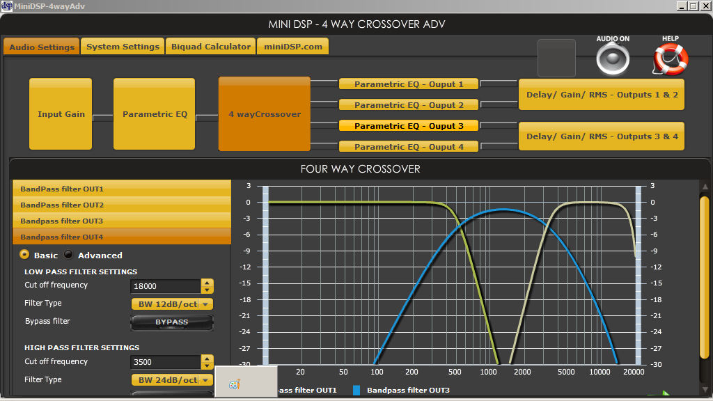

As I had a 3-way XO test bed already handy, it was just a matter of putting the XO settings into miniDSP. So here is the electrical XO I implemented in miniDSP:
And here is the resulting acoustic XO that was measured (yes the SPL levels are fairly low so that I did not wake up the family during sweeps). As you can see, the curves are fairly common and innocuous. The 1st order textbook curves of the B&O were especially hard to achieve in practice. With the Harsch topology 2nd order and 4th order are much easier to get. The tricky thing is what to do for the time delays? Well, it is exactly the same delay assuming driver acoustic centers are already time aligned. The mid needs to be delayed from the woofer by 0.5/fc_low and the tweeter needs to be delayed from the mid by 0.5/fc_high. For my case, I used a 500Hz and 3500Hz XO points:
495708d1437975878-s-harsch-xo-harsch-3-way-xo.png'
Here is the resulting Impulse Response:
And here are the resulting Step Responses - I know there is a little pre-rise but overall it is much better than a jumbled up-down-up-down mess you would see with an all LR2 or LR4 XO:
This is still a work in progress. Does anyone see any problems with it? I think this works. I am still having a problem getting the phase to be wrap free - it seems to wrap at the centeral frequency and not at the low and high XO frequencies. Anyhow, still debugging it. This XO may be useful for folks looking for an easy to implement quasi-transient perfect XO using IIR filters in DSP. How does it sound? Fantastic! My speakers are essentially 98dB sensitive and super loud and clean with this XO. I am really enjoying the sound and how the percussive sounds like guitar and drums really have a "live" feel to them.

My mic is at 1m and I think floor bounce or other reflections must be cause of phase wraps - I can count 10 phase wraps centered at 1.1kHz and I know the sound is coherent and not delayed 10 cycles (10ms) due to good IR and SR.
I forgot it is hard to get phase wrap free measurements when floor bounce potential is there.
