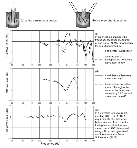

Did a bit more search, it seems that people are doing this in DSP. This would be an interesting approach for headphones if you could adjust it to individual head properties, But still, whether the original instrument/vocal was recorded in stereo or mono, how the mixing occurred would play a significant role in how successful the playback will be for each recording.
So if the left and right pair are EQ'd to flat based on the mono phantom center the dip would likely be the same or worse due to not changing the interference? If the dual channel dip level came up with the eq than when you have a strong single channel sound in the recording that channel will have a big peak where the dip is with both channels?
