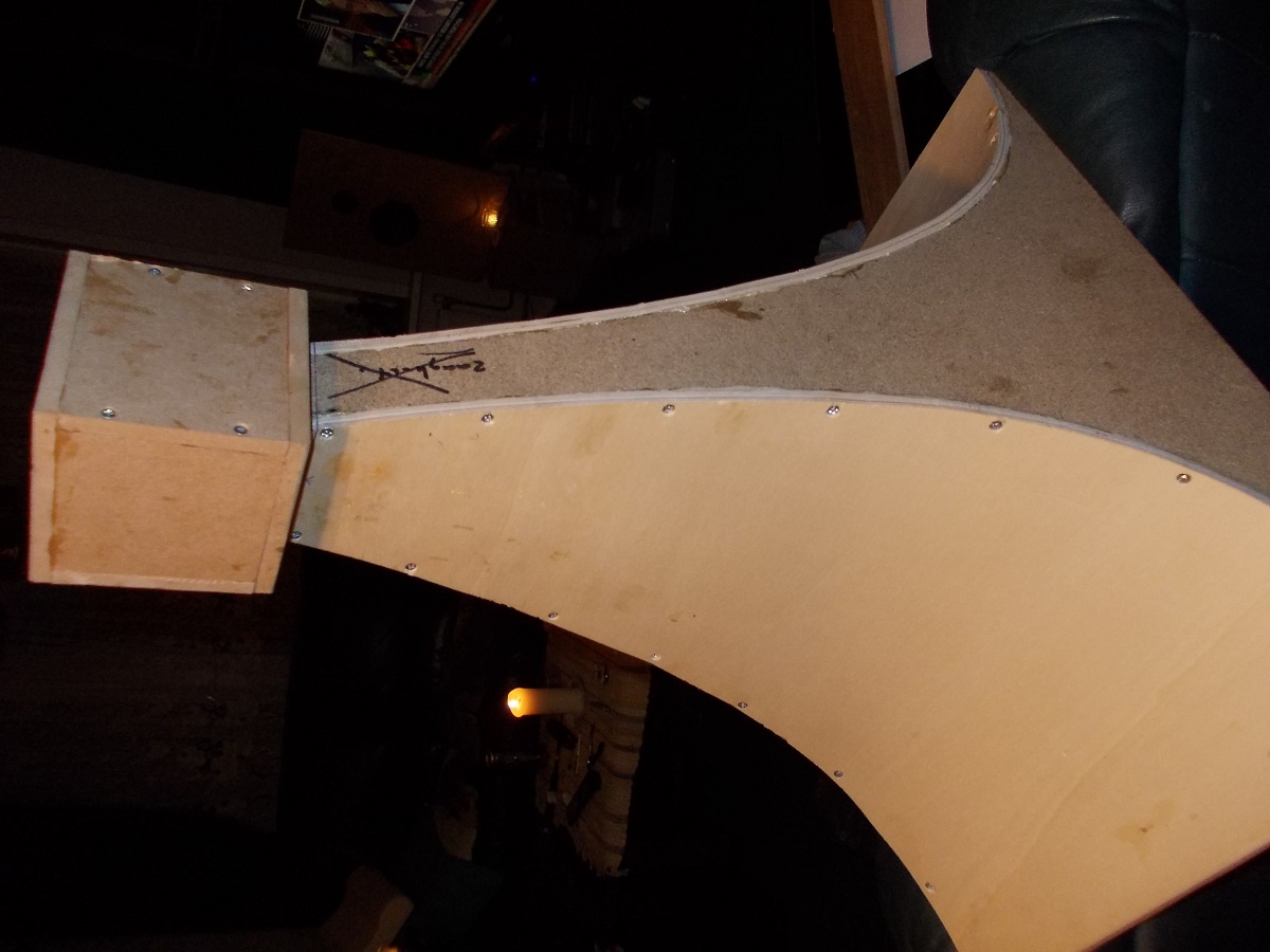

Kees552 has done a remarkable job building the full range tractrix synergy or Trynergy over in the Full range forum. I just wanted to bring it up to the attention of Multi way fans here because he is looking to make a phase plug to eek out the last bit of smooth performance from a 3in full range driver in a 2in square throat.
Here is what he has achieved so far with purely passive means - no EQ, no DSP, no PEQ, nothin' but a 6.8uF cap and elbow grease and a file. Remarkable for a single Visaton FR8.
More info here:
http://www.diyaudio.com/forums/full...ll-range-tractrix-synergy-53.html#post4464551
More info here:
