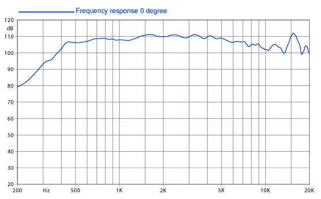

I've done a fair amount of testing on the HF146 with a 2.56" ketone diaphragm. It is breaking up above 9 khz, but much like a very well dampened paper or poly cone woofer the breakup is very well controlled with approximately +/- 2 db wiggles to the top of the response that extend out to 17 khz. A larger titanium diaphragm is going to look much worse.

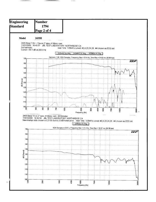

I'm really fond of the JBL 2384 horn with the 2435HPL driver (beryllium), it should be crossed at 650hz or so.
"A larger titanium diaphragm is going to look much worse. "
The large FP titanium have a 10dB peak around 15khz, some like the 'detail' it adds.
That needs to be zoomed in with a lot less smoothing.

"That needs to be zoomed in with a lot less smoothing. "
Sorry, graph was from a source I have no control over.
Will this do?
Will this do?
