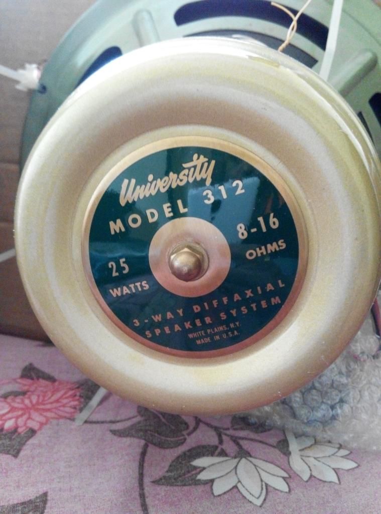

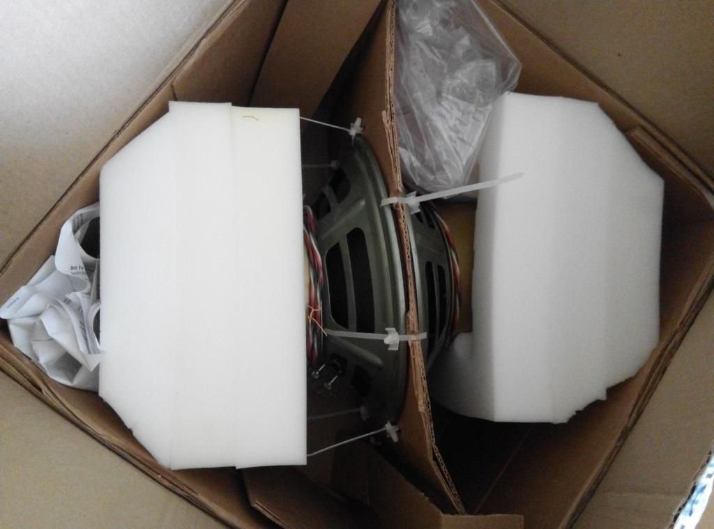

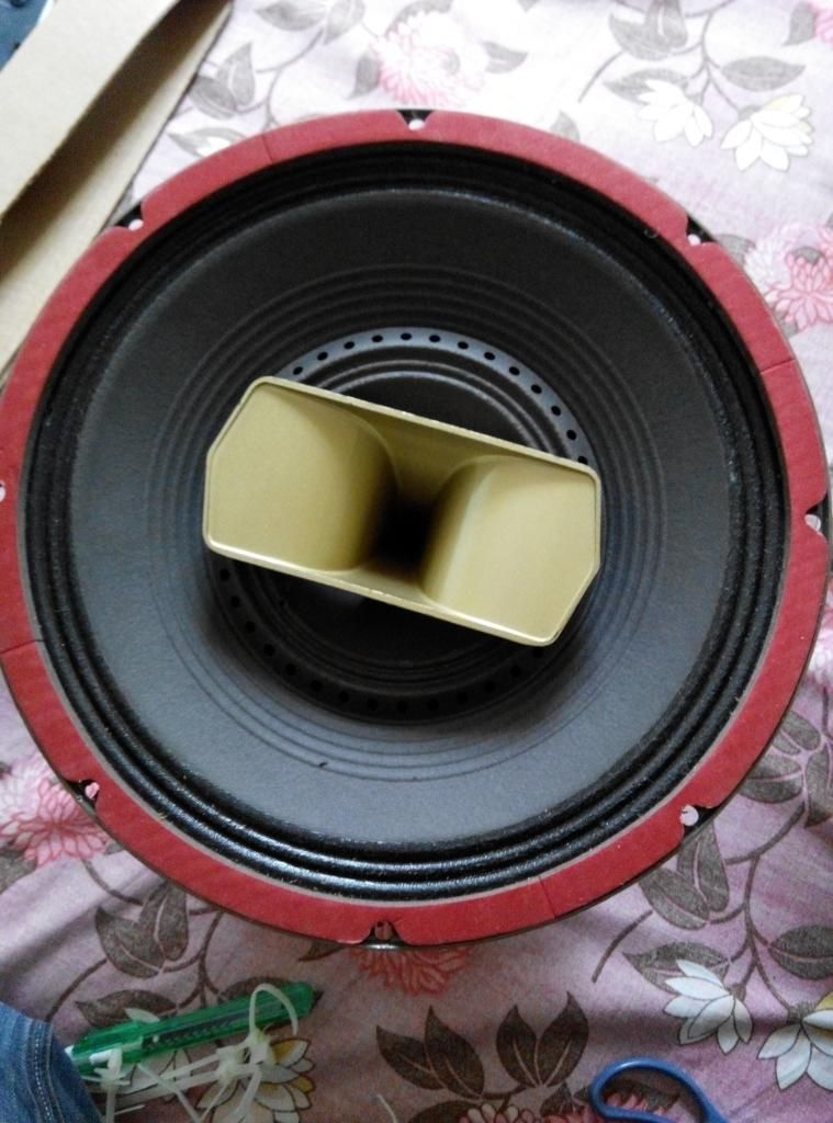

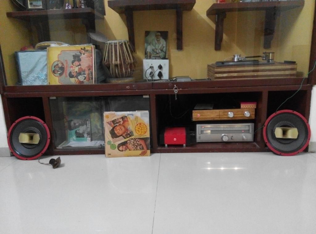

I am very lucky to get these drivers as a gift from a member at lencoheaven. I received them couple of days back. They are big and heavy. Packing was superb. I am listening to these drivers since I received them. I liked them very much especially midrange. They are playing very well in low volumes with my DIY Class A 5W Amp Camp Amp.
Does any one know TS parameters for them? I am looking to build beautiful enclosures for them. Kindly suggest some suitable designs for them. I am also looking to replace old 4uf cap. Any good capacitor suggestion?
Few pics:

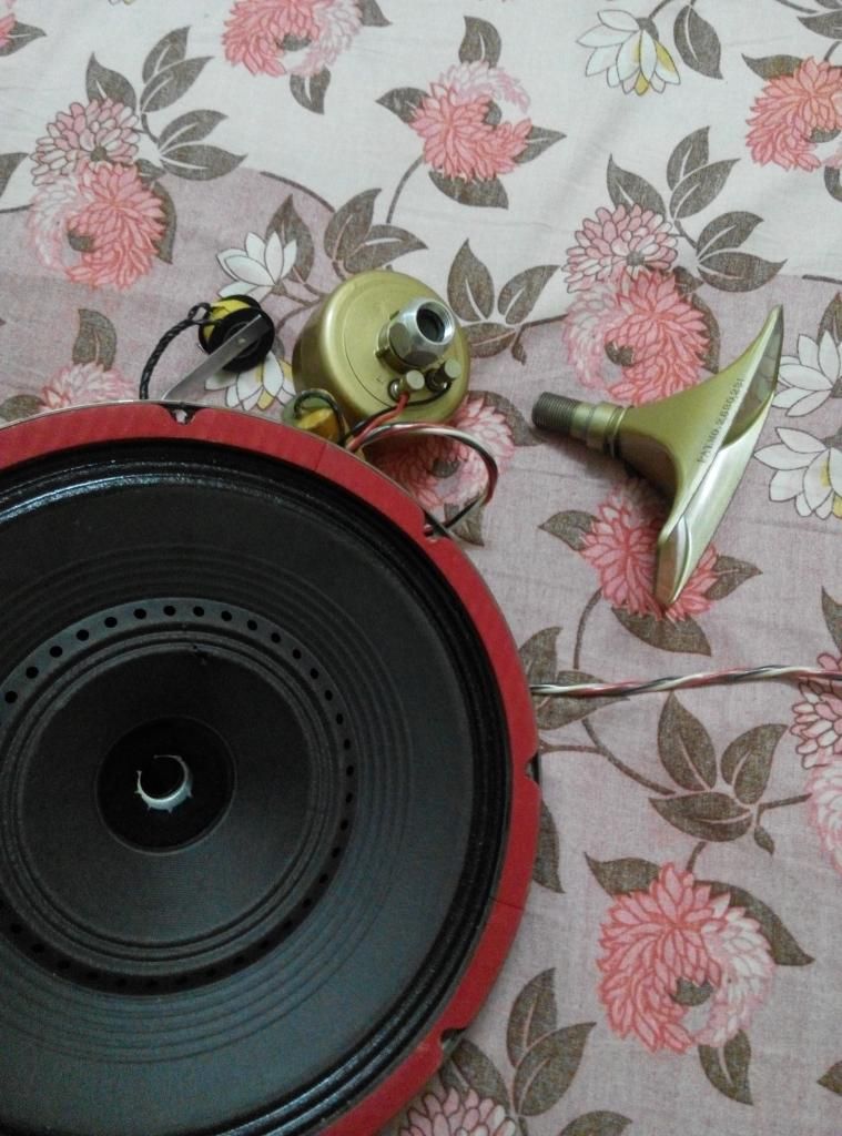

I am getting distortion if I increase the volume.I have verified coil rubbing or alignment problem in both the speakers. The Cone is making rubbing noise when pushed by hand.Can I DIY coil alignment, repair or replacement without damaging the cone and other parts of driver? I have searched on web and it seems there are no reconing kits available for University drivers.

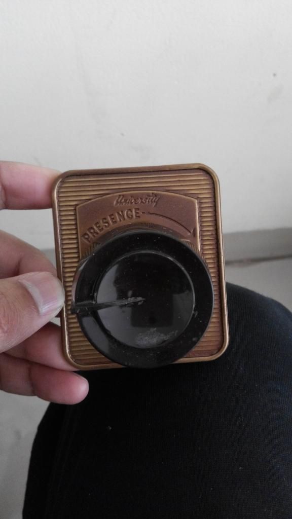

Pushing the cone by hand is not very precise and can "throw out" the alignment an give the impression of rubbing. As for the apparent rubbing when it plays music, have you tried rotating the drivers to see if it goes away? It may be sagging in the spider. Maybe that "presence" control is a bit worn out or dirty as well?

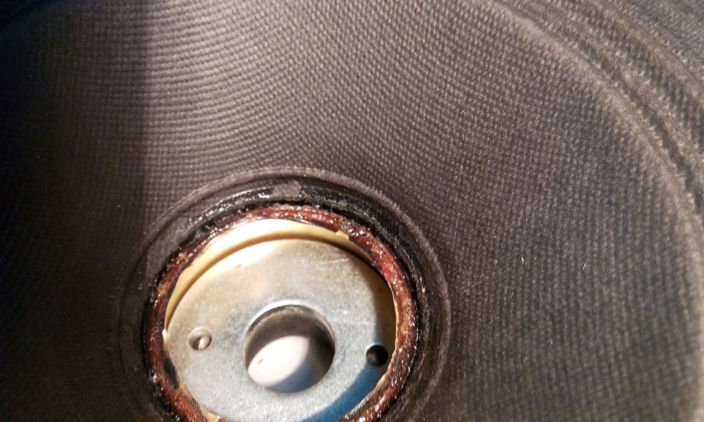

I did rotate them 180 degree, and played 2-3 days in same position. It did not solve the issue. Cone movement seems to be very stiff and its hardly moving. I have tried to clean voice coil, since there is no need to cut dust cap. I tried to clean it with very thin plastic strip by rotating inside voice coil gap. I could not rotate it fully 360 degree as It was getting stucked somewhere. I am attaching pics for reference.

The impossibility to go all the way around the VC with the thin strip might be indicative of something amiss.
I think VC alignment might have gone bad in shipping. I could only move thin strip in 3/4th part of circle inside VC gap.

A sagging spider should let you move the strip all the way around, with a bit more resistance where it rubs. Shifted motor assembly? Is that even possible the way this thing is put together?

Also, it's possible something fell (or crawled 😱) into the gap, seeing as there isn't a dustcap to keep stuff out.

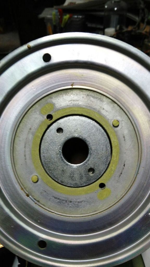

Success!!
I sent those drivers to my friend at another city. He took them to a common friends who has a great knowledge and skill. He has found out the problem and rectified it. Actually the problem was with pole piece shifted from original place. He had to cut one ring/cover from the back side to access the pole piece.
I am posting few pics for better understanding.
After removing the dust cap. You can see the coil gap is not even.
Back side
After removing the tweeter
Alnico magnet
He has repaired one driver. Another one will be done tomorrow. I requested him to take few pics out could be helpful for other members. He send me few recordings. They are sounding superb.

Great save!! I knew it could be done. Glad you found the a friend with the skills to do it.
Thanks for the cool repair pics. Looks like the HF motor is basically a big weight on the end of a lever. Presumably it torqued the pole piece out of whack during shipment. It's almost hard to imagine it wouldn't.
