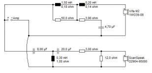

Hello System7! How are you? About one month ago I applied the tweaking you suggested to my system and so I took some time to listen, really short time. Unfortunately the 1.5 mH coil didn't help me to obtain presence in mid-bass band, rather I obtained very much presence and something wrong in the mid-high, which of course in certain musical program can be pretty but generally I don't like.
In this time I learnt to use Boxsim with frd and zma file traced from datasheet graphs and so below I'll show simulation of that (dashed simulation of New Vifa Tower as original):
as you can see there's too much middle presence and too much visible breakup.
So I want to look for another solution. I've seen your project using Visaton drivers; looking for nice and punchy response in mid-bass band woofer I'm interested about Visaton GF200 with coils in series, becuase of its high Qms and BxL: do you know this woofer? Have you got a way of listening it?
Anyway what kind of woofer do you know able to give punchy and energetic mid-basses?
Alternatively, below a proposal for a tweak of mine for New Vifa Tower, with mid-bass slightly emphasized and lower cross point @ 1200 Hz, what do you think about?
Thanks a lot : )

Lots of handwaving, waffle and opinionated rubbish, is
not going to help you a lot in sorting out your dilemna.
New drivers won't help and will be a world of pain.
http://www.datasheets.pl/SPEAKERS/VIFA/M21WO3908.pdf
The MB x/o certainly has BSC, and the big inductor is needed
due to the drivers quite high Le and rising top end response.
TBH I cannot work out the problem you are trying to fix.
IMO you need to detune the box to 28Hz,
that will certainly tune the 50 to 150Hz area.
rgds, sreten.
"For more than one year I've tried to improve this decreasing internal volume,
shortening the vent tube, attenuating tweeter, but what I got was always
boomy effect and need to return to the original configuration."
None of the above will help. Try making the port longer.
Try increasing the foam lining to say about 2" all round.
Reduce tweeter attenuation a little whilst unwinding
the inductor a little. Analyse your room for modes
and carefully look at speaker placement.

It is time for a review, I think. 🙂
We are looking at a big reflex like the WLM La Scala one on the left.
I think that will be a bit of a boom box by its very nature. Deep bass interacts with room gain.
The filter cannot totally correct that initial design choice. The bass reponse also seems to have a problematic tendency to bend at 1kHz when filtered looking at your modelling.
You could look at a 2.5kHz Troels design here for inspiration:
QUATTRO-mkII
Or persist with that 3kHz near LR4 filter that works for me.

Hello Sreten, I understand what you mean but trust me, as I talked about in my new thread there's nothing else I can do and nothing else I want to do, I've tried everything but hte problem is really my woofer, or if we want its belonging category or working philosophy, i.e. the mechanically overdamped/overcontrolled woofer, which is the most common in the high-end audio sector.
Simply I'm tired of extreme linearity, highest tonal balance or ultralow distortion, what I want is life, joy and fun by sound. Let me say I find more attractive music if I listen it by the my series Lancia Y car radio or, by memory, from my brother's old stereo, because of its "live" mid-bass band. It's a timbre question, I prefer a woofer which "sings" even slightly unfaithful but "sings".
All I'm looking for is so a nice timbre and audible strenght in mid-bass band.
Vifa, like somebody said, is "a delight" in frequency response, undoubtly, but simply it's not my first need.
