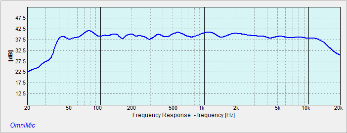

Focal 6W3253 full range measurement with 1/6 octave smoothing

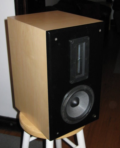

Here's what the speaker looks like

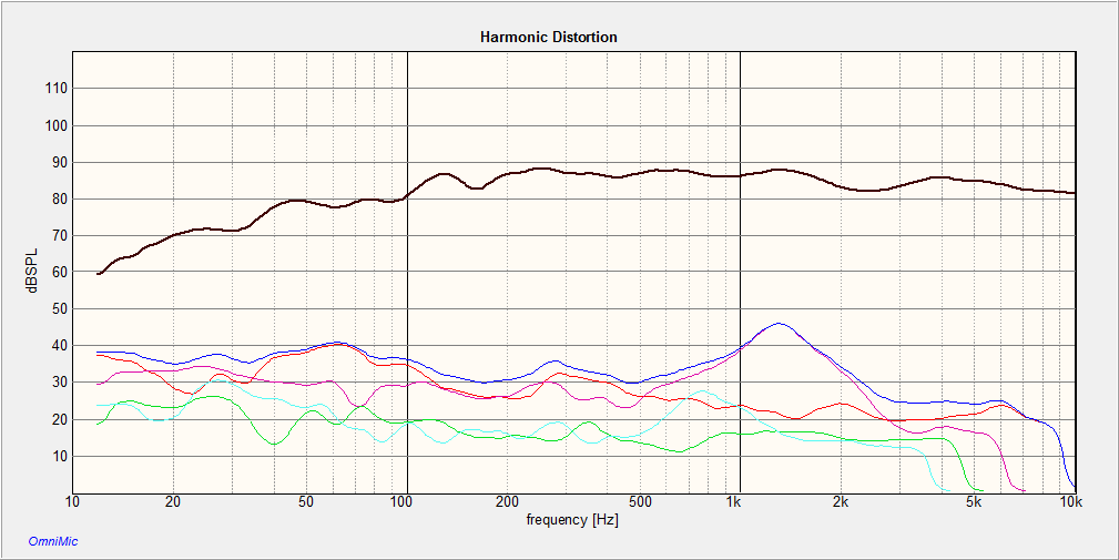

So this sounded ok, here's a response curve and harmonic distortion curves I ran, at 90 dB SPL at 3 meters with THD being in blue, 2nd harmonic in magenta. You can see a bit of a peak in distortion near the 2500 Hz crossover point.
OK so this is not really terrible but just did not satisfy me. And in the end, these 0.75 cu ft (21.24 L ) cabinets were just too big for my workshop; I ended up building a pair of 0.25 cu. ft. sealed boxes with SEAS EXCEL SEAS W15CY-001 5.5" woofer and 'Millennium' tweeter with a crossover designed for me by Rick at Selah Audio. These have worked just fine, they sound great- a wonderful detailed neutral sound.

This one started as a pair of 2-way speakers for my workshop. I had some Focal 6W3253 6-inch drivers, and I'd always been fascinated with Focal's better drivers- based on my hearing some of their finished speakers. So, OK, a 6W3253. I also had a pair of Fountek Neo CD 3.0 ribbons lying around. I tried to design a crossover but couldn't get anything I was confident would work, so I paid Madisound to do a LEAP xover for me. I put the drivers in a Parts Express 0.75 cu ft box, sealed alignment.

And here's an in-room OmniMic FR plot of the EQ results using the DEQX FR curve as a starting point. HF rolloff about 15 kHz may be an artifact of mic placement, or it may be real- I can't tell as I can't hear up that high. This is 1/6 octave smoothing, with a "spliced curve" below about 500 Hz - bass curve with a longer impulse window than the treble part. It's about +/- 2 dB from 40 Hz to 15 kHz.

The speakers look like this
