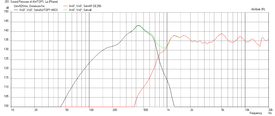

Sim results v1
Using Weltersys's sketch above and making a few assumptions, I came up with the following design:
- 3.0 in dia CSA port injection holes for the qnty 3 x 10CL51's, ports located 3.0 in from throat (axial distance)
- Qnty 4 x 4.0 in dia x 8 in long bass reflex ducts ported into horn walls at 12in axial distance from throat
- Rear chamber volume is 40.4 liters based on 30in wide x 10in tall x 15in deep with pyramidal horn volume subtracted out
- Driver volume between cone and horn wall is 500 cc's (if needed make a volume filler insert - needed to extend bandwidth higher)
- Woofers connected in parallel
- I don't have a model of the internals of the Celestion CD, so I am using the available B&C DE250 - which will not go as low as a 3in CD diaphragm with 1.4 in throat - however, substitute later and adjust XO and EQ as needed.
The mid drivers will need to be EQ'd to level the main port injection output with the lower SPL bass reflex output. Max sustained SPL (AES rating of driver) is 127dB at 1m. 6mm xmax limited SPL (peaks) is about 132dB SPL at 1m.
Overall, I think this design is quite simple and can work well if given appropriate DSP EQ'ing and delays. I used an allpass delay of 550Hz between the HF and LF to get time alignment needed at the XO region. I am using a 500Hz 24dB/oct XO to limit the ragged peaks from the main injection port - could be made a bit higher like 700Hz and still work. A -12dB/oct HPF at 80Hz is used to limit cone excursion at low frequencies.

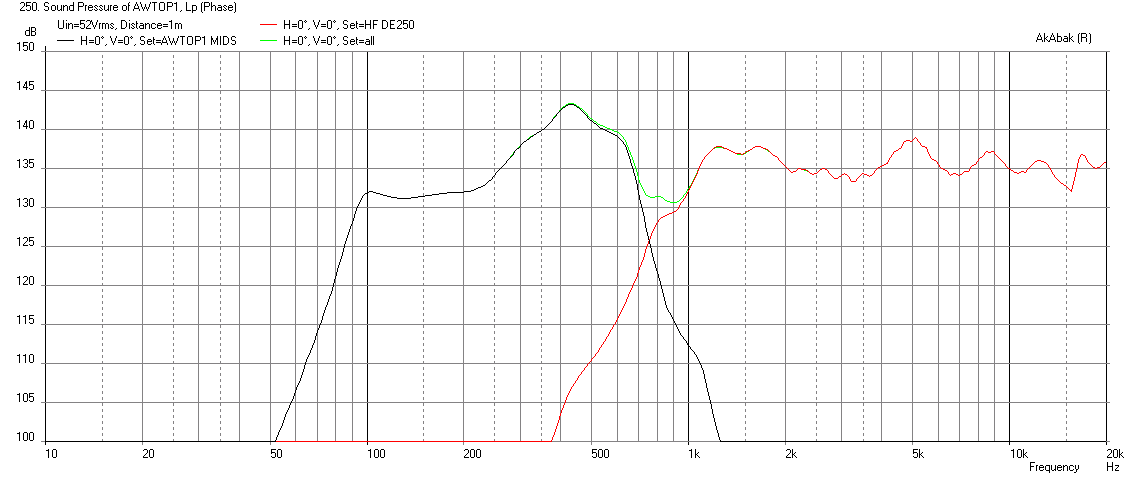

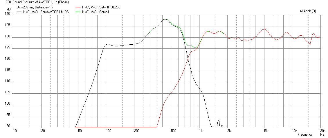

Max SPL at AES rating of 450 watts:

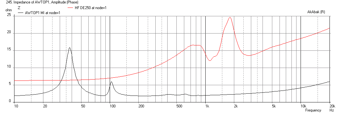

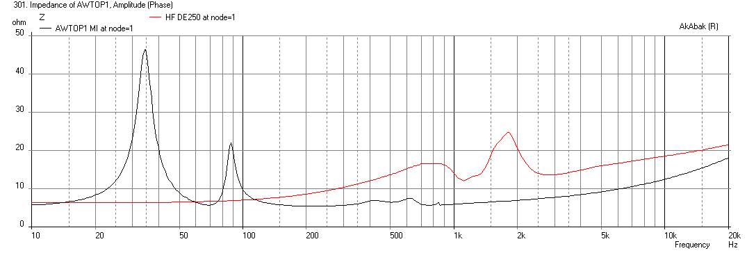

Here is Impedance:
Here is Cone Displacement at max thermal input power:
Here is corresponding peak SPL at xmax:

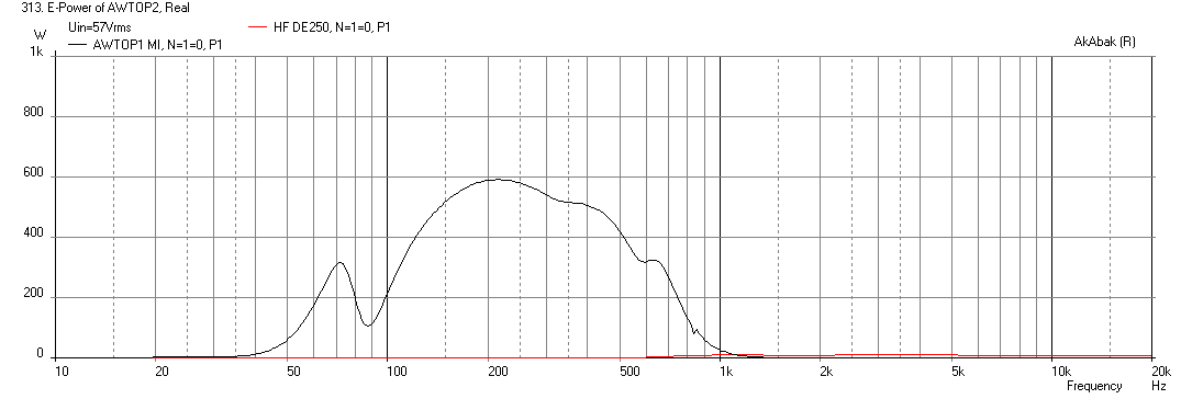

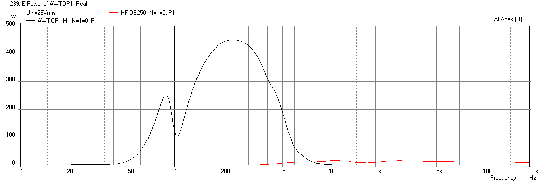

Here is Electrical Power input at max power:
Here is the response at max SPL assuming a sealed rear chamber:

I guess the burning question will be what does it look like without the secondary expansion? I will run those when I get back to the AkAbak computer again.
Xrk971,Using Weltersys's sketch above and making a few assumptions, I came up with the following design:
1) 3.0 in dia CSA port injection holes for the qnty 3 x 10CL51's, ports located 3.0 in from throat (axial distance)
2)Qnty 4 x 4.0 in dia x 8 in long bass reflex ducts ported into horn walls at 12in axial distance from throat
3)Rear chamber volume is 40.4 liters based on 30in wide x 10in tall x 15in deep with pyramidal horn volume subtracted out
4)Driver volume between cone and horn wall is 500 cc's (if needed make a volume filler insert - needed to extend bandwidth higher)
5)Woofers connected in parallel
6)I don't have a model of the internals of the Celestion CD, so I am using the available B&C DE250 - which will not go as low as a 3in CD diaphragm with 1.4 in throat - however, substitute later and adjust XO and EQ as needed.
7)I am using a 500Hz 24dB/oct XO to limit the ragged peaks from the main injection port - could be made a bit higher like 700Hz and still work.
8)Attached is the spreadsheet used to obtain the geometry for a 90deg x 35dgeg horn with a 30in wide horizontal mouth at the second expansion angle. Also attached is a scan of the geometry sketch that I am using based on the spreadsheet.

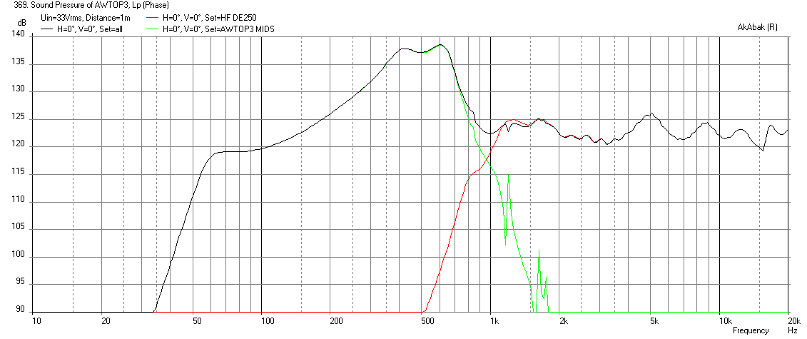

V2 with 76 liters and 4 x 10CL51's
Weltersys,
I adjusted the volume to 76 liters as you say. My volume used earlier was actually 49.4 liters based on 10in H x 15in deep x 30in W, but in any event, I used 76 liters as that probably matches the external box you were thinking of more. I added the fourth driver for series-parallel, and as expected, the sensitivity for same voltage went down but you can go to a higher voltage. The increased volume gives an 80Hz extension before it starts to fall off. Still using qnty 4 x 4.0 in x 8.0in long bass reflex vents. I also tried removing the front piece, surprisingly, you don't lose too much efficiency. The pattern control may not be as smooth, but seems like a nice compact option. XO is now at 700Hz, and -12dB/oct HPF is at 67Hz. Regarding changing the Sd on the CD - it is not as simple as changing Sd, the internal geometry of the phase plug and channels, coil diameter, Mms, etc are all involved. If you want, I can put a model of the JBL 2450 2 in CD in - I have that model somewhere. I don't think it matters as long as you know your CD can hit 700Hz for the XO. Even with the DE250, it appears that it may work at 700Hz, although not sure how accurate the model of the DE250 is.
Here is 4 drivers with 76 liter rear chamber, vol of front driver chambers are 420 cc's (adjusted to get smoothest response) at thermal AES max of 600 watts which is about 4mm stroke on the woofers:
Impedance:
Electrical power:

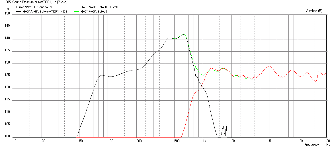

Response with secondary expansion removed:

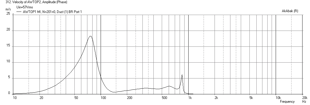

Vent velocities at max power in case you are worried about chuffing (seems ok at 17 m/s):
I hope all this helps confirm your idea for this design - I think you should go for it. Having a 2-way seems to really simplify things and keeps the costs and complexity of the drive electronics to a minimum. This may even allow someone who knows what they are doing with passives to make a passive 2-way XO.

V3 tuned to 60Hz with 2 & 3 drivers
I swapped to the four ports to 3 inch SCH 40 PVC (3.042in dia) x 8 in long and this seemed to bring the tuning down to about 55Hz. This is the full horn with the extension. This is all 4pi space now, no reflections but diffraction is still turned on.

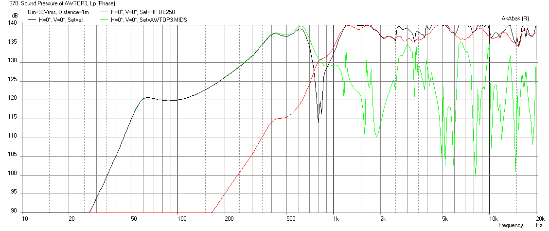

3 drivers without filters:
3 drivers with filters (-12dB/oct HPF at 54Hz and 24dB/oct XO at 700Hz) at xmax:
2 drivers without filters:
2 drivers with filters (-12dB/oct HPF at 54Hz and 24dB/oct XO at 700Hz) at xmax:
Port velocity at xmax for 2 drivers:
Port velocity at xmax for 3 drivers:
Velocity is kind of high at 35m/s - possible chuffing and port compression.
