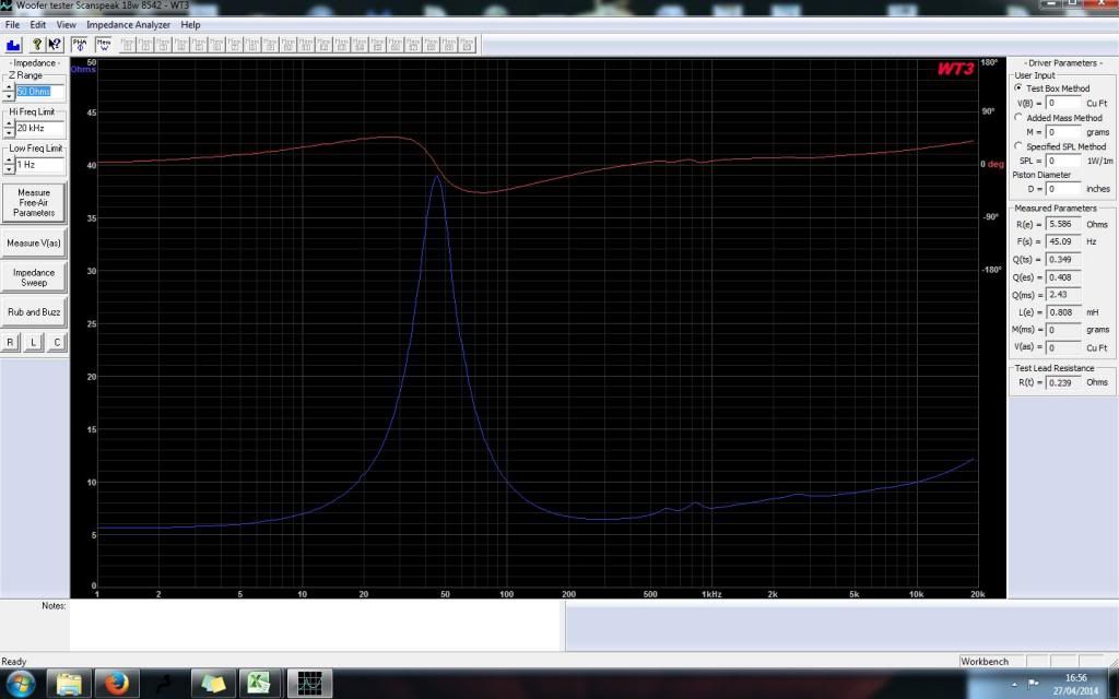

Here's the Woofer tester results:
I still need to run them in though.
You don't show a value for Vas.
I varied Vas to make the other parameters (mass, Bl, etc...) match the original spec and I got a Vas of around 21 Liters.
Assuming that is about what you get when you actually measure Vas, performance in the box will be almost identical to the one with manufacturer spec. Cms changes (increase in Fs and decrease in Vas - or vice versa) don't always affect box design as much as you might think. The signal level at which the parameters are measured also makes a big difference in measured parameters.
