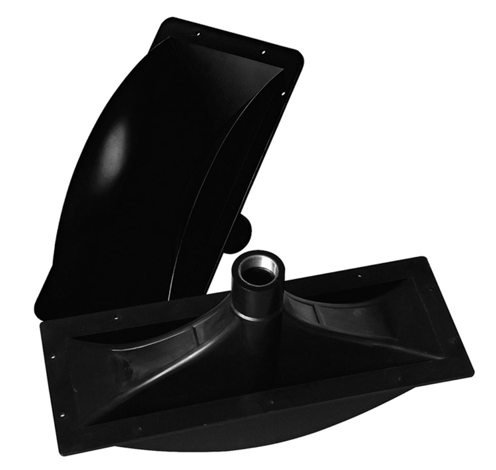

In a few posts on this forum, I'd argued that narrow angle horns had higher output on axis but rougher response, while wide angle horns had less output on axis but smoother response.
Art had argued that this is not the case.*
So I decided to do some measurements, to determine if my statement was incorrect.
The horn at the top is a 90x90 round waveguide sold by QSC.
The second horn is a 90x60 rectangular waveguide sold by QSC.
The last horn is a car audio horn with a narrow vertical angle, about 20 degrees, and a wider horizontal angle, about 40ish. (Hard to say exactly because it's a horn not a waveguide. The shape looks similar to an exponential horn.)
Here's the measurement of all three, on the same graph.
The yellow, cyan, and violets curves are the on axis response of the round, rectangular, and car audio horn.
The red, blue, and purple curves are the 45 degree off axis response of the round, rectangular, and car audio horn.
Based on these measurements, I'd say the differences between the 90x90 and the 90x60 degree horns from QSC are small. If anything, the narrower horn is a little bit smoother. OTOH, the frequency response of the car audio horn is noticeably rough.
In this measurement, I've omitted the car audio horn to highlight the response differences of the two QSC waveguides. Above 5khz, the response of the two waveguides is within +/- 3dB of each other. Below 5khz the larger waveguide has more output, but they're both very smooth. I believe the larger waveguide has more output below 5khz simply because the smaller waveguide has a large integrated roundover in the waveguide.
In this illustration I've overlaid a 90 degree cone on the round QSC waveguide; I've done this to illustrate how a substantial amount of the waveguide's dimensions are the termination.
Based on these measurements, I believe that Art is correct. Narrow angle waveguides aren't inherently more ragged than wide angle waveguides. The majority of my experience with horns and waveguides is in the arena of car audio, and I'd long assumed that the ragged response of car audio horns was something that's shared with ALL narrow angle horns. This is not the case apparently.
Hopefully I don't get myself in MORE hot water with a hypothesis of mine, but my hypothesis about the car audio horn is that the frequency response is ragged due to high order modes. If you look at the impulse response of the car audio horn, there's a huuuuuuge tail of reflected energy. My theory is that this is due to the 90 degree bend that the compression driver fires into.

Some notes on the measurements:
1) All measurements use the same compression driver, a Celestion CDX1-1425
2) I didn't take pictures of the horns today; the pictures in the first post are old pictures that I took. So even though there's a BMS 4540ND in one pic, I didn't use that.
3) The 45 degree off axis curves have been lowered by 10dB to make it easier to see the data on the same graph
4) I had the mic in a fixed location to insure that the curves were accurate
5) I rotated the horns and waveguides in place to insure accuracy. (Basically I noticed that the curves would vary by a dB or two if I wasn't careful, so I paid special attention to the location of both the mic and the horns.)
Here's a couple more examples. The yellow curve is a Pyle PH714, a 90x40 degree horn that measures 16.5" x 6.25". The cyan curve is a Pyle PH12S, a "90x40" degree horn that measures 11.6" x 11.6". I put "90x40" in quotes because the PH12S is nearly twice as tall as the PH714 and it's vertical coverage is clearly larger.
The difference between the two curves isn't significant, except for a blip at 5.5khz and 15khz. The latter is likely due to a bit of a mismatch between the compression driver and the horn. (The Pyle horns leave a gap of about a millimeter between the compression driver and the horn, and the gap is worse with the PH714.)
The yellow curve is a Pyle PH714 on axis, the red curve is the same horn 45 degrees off axis. The cyan curve is a Pyle PH12s on axis, the dark blue is the same horn 45 degrees off axis.
IMHO the PH12S is a bit smoother than the PH714, but the QSC waveguides are smoother than both. That may be due to the compression driver, a mismatch between the horn and the compression driver, the geometry of the horn, all the above, or something else. The compression driver is a JBL 2408H-1.

I was looking at this response graph, and it seemed like a lot of the lumps in high frequency may be due to an atrocious step that exists in the throat of the Pyle horns.
The gap in the throat is huge; I was looking around the garage to find something that would smooth the transition. Tried using 1" PVC but it's a bit too big, because the outer diameter of PVC is 1.3". I found some spacers used with wire shelving, and due to their taper, they seemed to be a good place to start.
Here's that spacer IN the throat of the horn; despite being about 1.25", it actually fits! Yowza. That means there's a "step" at the throat that's about three tenths of an inch. That's ugly.
I popped off the bug screen and that makes it easier to see the step. See that silver ring? That should be hidden if the throat was a good match for the compression driver. The gap is so huge, for a second I thought the JBL might be a funky size like 7/8". But this isn't the case; the Pyle just doesn't match.
I stuck some clay in the throat, and did my best to smooth the transition from compression driver to horn. Here's the results of that. I used some EQ and a low pass on my MiniDSP to flatten out the response.
1) yellow is on-axis
2) orange is 15 degrees off axis
3) red is 30 degrees off axis
4) the lowest orange curve is 45 degrees off axis
5) The blue curve is the average of the first four curves.
The response curve isn't perfect, but it's improved, and I think the curve could be even better if I used something like Bondo instead of clay. (It's hard to get the clay perfectly smooth.)
Here's the vertical polars of the same horn. Blue is the average of 0,15,30 and 45. The verticals are a bit smoother than the horizontals, except for a nasty dip at 13,500hz. 13,500hz is one inch long, and I wonder if that dip is due to the parallel walls in the diffraction slot. You can see the dip in the on-axis of the horizontals, but it gets smaller when you get off axis. So it may be possible to use this horn in a speaker that's designed for listening off-axis. For instance, if you look at the 30 degree curves of the horizontal axis, they're smoother than the on-axis curve of both the horizontal and the vertical.
