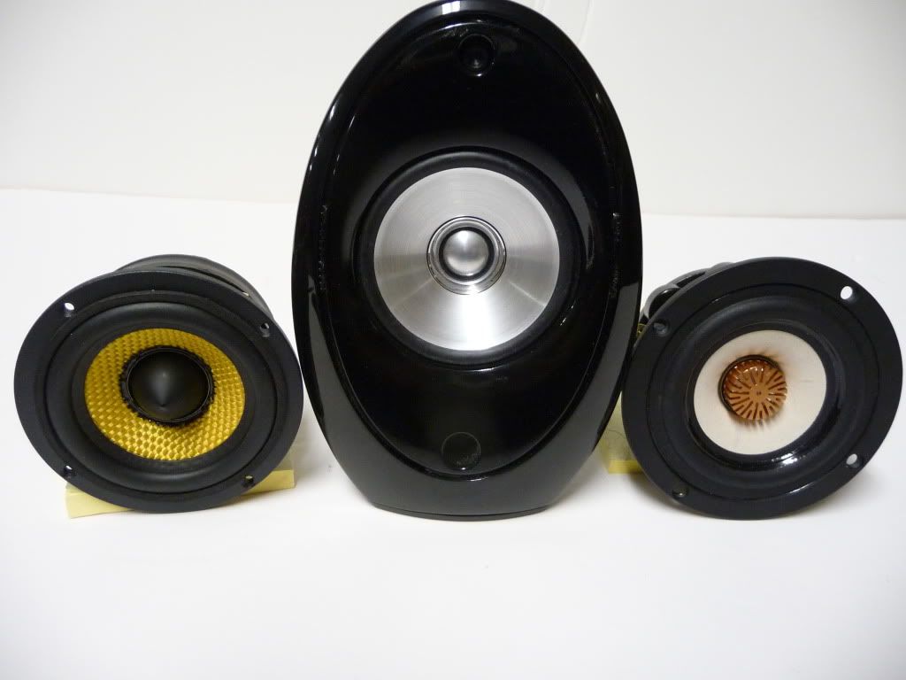

All pictured speakers have bad transition from tweeter to horn's throat. Air turbulence created at the throat will be amplified. Also, shape of compression driver phase plug is very important, if turbulence created at that stage, none of the horn designs will help. I think Summas sound the best, because of foam plug, it levels out all air turbulence.
Back in the 1970's a certain Mr. Iwata in Japan came to similar conclusions. The story goes that he was given the task of fixing the shock waves caused by the Bullet Train coming out of tunnels at high speed. Apparently quite a problem. He came up with a series of slots or vanes that tapered at the edge of the tunnel. Problem solved, shock wave killed.
He then turned his attention to his horn system, added the same series of vanes at the exit and smoothing the abrupt transition form horn to air. I've seen photos of his system, all the horn mouths are done that way.
As Bear stated, Jean-Michel LeCleac'h took this further and came up with a profile that has a large round-over at the edge, making for a better and less abrupt exit. "Rabid Horns" (foam at the mouth) can also do a lot to smooth the transition. You can test it ourself with a couple of towels at the mouth.
I have no idea what works best, soft edge, rounded edge or a combo of both. They do seem to work, tho.
