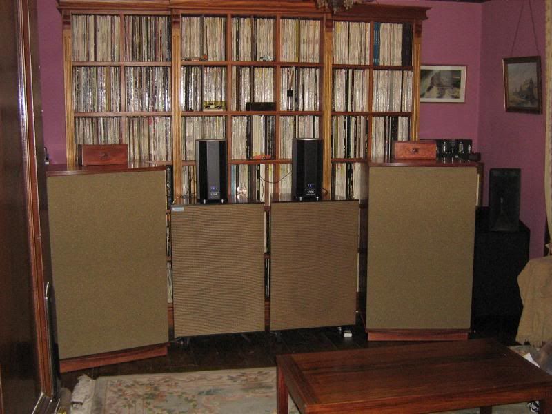

The K10A's are now back home with me resplendent in the new cabinets that Steve built. The quality of finish on the cabinets is superb.
I the last couple of days I've probably played every genre of music through them and if one thing stands out it's the effortless ease that music just flows from them. There is no bass boom or thump, just very a natural, realistic presentation of instruments and vocals. The adaption of a scaled up GRF design really works. The HF integrates well with the LF and I have never found K10A's to be lacking in HF extension or detail.
Steve's pics don't convey how large these cabinets really are. This is the K10A's together with my Westrex 2626A's and JBL Array 1400's. The JBL's look tiny by comparison.
