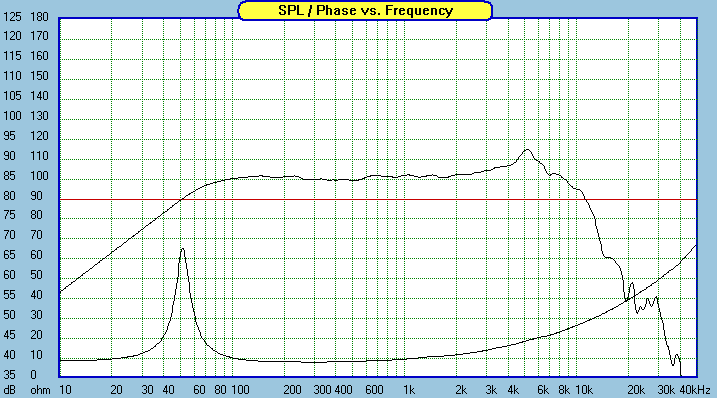

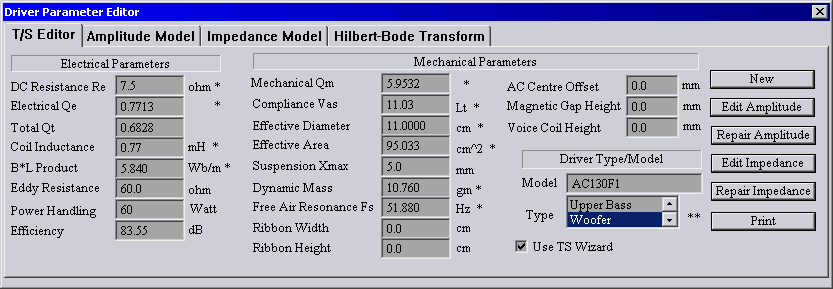

Designing a x/o is not a trivial matter and ideally the MTM for
the centre would be different to the other MTM's somewhat.
look at the discussions here :
Zaph|Audio - ZA5 Speaker Designs with ZA14W08 woofer and Vifa DQ25SC16-04 tweeter
Also Zaph|Audio
Click the image to open in full size.
The Aurum-AC130F1 is quite a nice driver suiting sealed and well
stuffed boxes. MTM 2 way is better than MTM or TMM 2.5 way.
With a baseline Qts of 0.7 you going to have to accept some
bass peaking and control this with offset AV x/o settings.
Information as to how to design a proper x/o is in the links below.
Implement some baffle step and choose your x/o points and tweeter wisely.
rgds, sreten.
