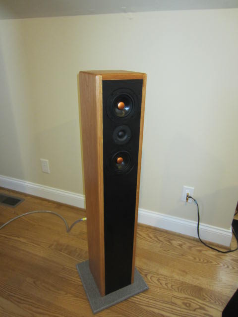

My MTM design with the CSS drivers is realized as a mass loaded transmission line (MLTL). The MLTL configuration extracts optimum bass performance from these drivers per this size enclosure. I call MLTLs speakers with legs--the stand or base for a bookshelf speaker aren’t necessary as the MLTL yields a tall floor standing cabinet. MLTL design efforts are aided by Martin J. King’s MathCAD based worksheets.
The basic assumptions for my efforts were to retain several key elements of the Bagby Triton bookshelf design including the cabinet wide (7.5 inches), driver spacing, and the tweeter height at 35 inches as Jeff recommended. The ultimate goal was to be able to use the original Triton crossover design and its inherent baffle step correction. My contribution was to lower the bass 3 dB down frequency of the bookshelf speaker which was measured at 52 Hz by Jeff.
After working through the MJK worksheets, I have a MLTL MTM design that satisfies the design goals. It is a straight MLTL with no fold or taper so it is simple to construct. The 3 dB down frequency response is 37 Hz while the port terminus dips at 43 Hz. The outside dimensions are 7.5” wide by 8” deep and 42.5” high. Assuming 0.75” thick walls, the internal cross section dimensions are 6” wide by 6.5” deep, and 41” high. The tweeter is centered at 7.75” from the inside the top while the mid-woofers are centered at 3.5” and 12” from the top respectively. A one inch baseplate would raise the tweeter to a 35" height.
Similar to most vented box designs, the length of the port tube determines the 3 dB down frequency for the bass response of the MLTL. For the 3” diameter port tube the tube length is recommended to be 6”. During my simulations I studied various other port lengths ranging from 4.5” to 9“. For 4.5, 6, 7.5, or 9 inches lengths, the 3 dB down frequency response is 40, 37, 35, and 33 Hz, respectively. The 7.5” and 9” lengths would necessitate either a curved tube inside the enclosure or extension outside the box.
Common with vented boxes, the MLTL mid-bass drivers will have increasing cone extension at the low end of their frequency range as input power increases. For this MLTL the linear cone extension reaches maximum cone extension at an input of 30 watts at 37 Hz. For the VWR126X drivers the linear extension is specified to be 5.8 mm. The SPL produced at this limit is 105 dB. While these MLTLs aren’t subwoofers, this is an impressive SPL level for small mid-bass drivers.
Prototype speakers have been built to demonstrate the performance of the MLTL design. Pictured are the Triton MLTL MTM speakers. The cabinets are made with cherry hardwood side and top panels (no veneer on these speakers!) and laminate covered MDF front and rear panels. The cherry hardwood and the copper color dust covers provide a stunning appearance to these speakers. The port tube and terminal plate are located on the rear of the boxes. My units use a Corian baseplate with floor pads.
Inside these cabinets are braces which strengthen the enclosure. While the cross-sectional area of this MLTL is small, my experience is that the highest pressure inside the box is at its top. Four braces are used inside the box. The first brace is under the top as the brace encircles the perimeter of the top. Just beneath the lower mid-bass a ledge brace encircles the box and a similar brace is placed at the bottom of the box. Finally, a bridge brace adds structure to the area of the tweeter. All braces are implemented with 0.75” square hardwood dowels.
For damping and frequency response smoothing the volume from below the drivers to the top of the box is filled with teased Acousta Stuf damping material. A wire screen rests on the ledge brace and retains the stuffing within this volume. The simulated stuffing density was 1 pound per cubic foot which equates to approximately 0.33 pound for each enclosure. Another damping technique is to line the internal surfaces of the panels with Sonic Barrier VE-1 vinyl sheets. Essentially, this material mass loads the panels so that any box vibration would be attenuated--these cabinets pass the knock test!
The crossover network derived by Jeff Bagby was divided into separate tweeter and mid-woofer boards. The tweeter board was mounted inside the box behind the top woofer (on the rear panel) while the mid-woofer network was placed behind the terminal plate on the front panel.
I’m just into the break-in of these speakers at this point but they have the same magic that I heard with Bryan’s speakers. Jeff’s design images like crazy and now you have additional bass extension. Hence, this design can make you grin. They reproduce music with excellent results. Only if you need bass within the 20 to 40 Hz octave, would you have to add a subwoofer.
In future postings I will more include additional details on this MLTL design.

Yes, Dave the stuffing is only in the upper third of the box. I've had success with previous MLTLs with this damping scheme so that is my starting point. Do you have experience that would mandate additional damping below the drivers? If necessitated, additional damping would easy enough to add.
By bridge brace I mean two short dowels (attached on the back of the front baffle) that extend from each side to the edge of the tweeter cutout. A longer (the same width as the baffle) dowel would be glued on top of these two shorter pieces and extend over and clear the rear of the tweeter. Thus the baffle would be strengthen and have better support between the two woofers. In the bookshelf Triton MTM build threads others have essentially used dowels between the rear panel and the front panel in this same area. Now my cabinet as constructed is very solid but I'm sure that bracing improvements can always be achieved. The tradeoff is whether more extensive bracing is necessary given the cross-sectional area of this box. I'm open to any suggestions that you may have.
