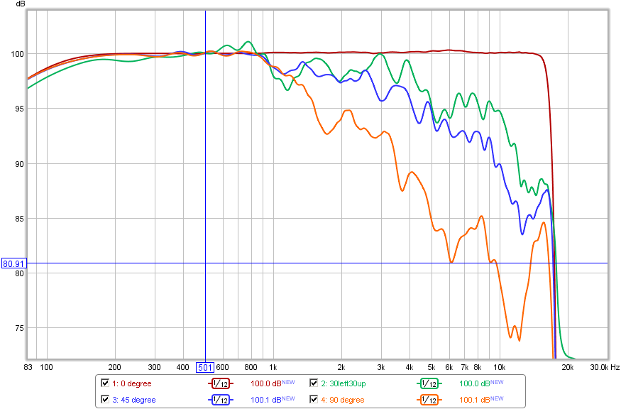

Measurement at 42", no smoothing:
Same measurement, gated to 3ms:
45 degrees off axis horizontal: Gated and un-gated results are shown. Rest of results are all gated. (Click on picks to enlarge)
90 degrees off axis horizontal:
30 degrees horizontal and 30 degrees vertical above:
15 degrees below:
Speakers do square waves within bandwidth constraints, waveform fidelity to what is on CD/normal listening material is extremely good, and they sound fantastic, no audible digital artifacts.

Andrew, can you stack those off axis onto a single graph so that they can be compared? And can you make the graph larger?

While we are at it - are those off-axis measurements made by moving the microphone or by rotating the speakers? If the latter, I wonder how much measurements at say 50 or 100 cm left/right from the "EQed" position would differ from the "ideal" one.

Overlays of axis/off axis measurements, ported to REW:
Plots referenced to 100dB at 500Hz, 20ms Blackman-Harris windowing, and 1/12th octave smoothing.
Speaker stationary, microphone moved.
Workhorse software is Cool Edit Pro2.1 with Aurora plugins, and Sourceforge Convolver plugin.
Microphone is Earthworks OM-1, older, but very similar to M30. Extremely flat response.
Sound Card is E-MU 0404 USB used with Cakewalk Sonar for measurements.
Playback on Roland Octacapture USB using Windows Media Player with Convolver plugin. Octacapture clock is synchronized to E-MU clock.
Also works perfectly fine with ancient Creative SoundBlaster Extigy USB.
Also Octacapture works with Console hosting Convolver, allowing standalone operation with selection of analog or digital input.
