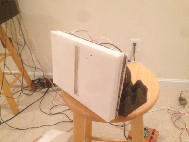

So if you look at the measurements above, the dual DOSC looks like crap.
Honestly, at first I was a little disappointed. As I reflected on the results, I started to realize there are some things going on here that are pretty special:
1) These things can take a TON of power. I had my measurement amplifier cranked up to 90% and the dual DOSC wasn't even stressed. I like the Eminence N151M and the Airborne RT-5002, but they will EXPLODE if fed that much power. The Airborne's power handling is 50W, the N151M is 45 watts. The Dual DOSC is 240 watts. This thing is a MONSTER. I've been measuring speakers at my house for over a year now - today was the first time a neighbor complained.
2) Of all the Paralines and DOSCs that I've ever built, the DOSC from 2017 loaded with a 3/4" silk dome tweeter (https://www.diyaudio.com/community/threads/square-pegs.217298/page-54#post-6972249) has the smoothest response. The very same DOSC waveguide, loaded with a compression driver, measured worse. So there's a clear trend here: if you make a DOSC with a larger tweeter or compression driver, the polar response will suffer. If you make a DOSC with a smaller tweeter the polar response is improved, but output levels and low frequency cutoff suffer. So there's no "free lunch" here, you basically have to decide between maximum output or smooth polar response. Even the Airborne ribbon exhibits this conundrum; it's polar response is smooth but it cannot handle the power that the dual DOSC can.
I came pretty close to making ANOTHER version of this DOSC tonight. Basically I think the dip at 15khz can be eliminated if I reduce the width of the channels in the DOSC. They currently start out at 4mm and are 8mm at the exit. 30khz is 2.27mm long, and I think the dip is caused by:
1) a half wave resonance when the channels are 4.54mm in diameter
2) or the volume of air in the chamber in front of the tweeter
DOSCs are tricky, because I'm not 100% thrilled with this device, but I can see how they can be really useful. If you combine two tweeters and two DOSCs, like I did, you wind up with a device that can eat up 240 watts of power and that has pretty good polar response from 1khz to 15khz. It doesn't have the "sparkle" of a 3/4" dome tweeter but I'm not aware of a small dome tweeter that can take 240 watts.
What's particularly interesting is that the vertical polar response is even narrower than a ribbon, and I think you could arrays these with nearly no limit. I'll bet you could array ten of these together, maybe even twenty. Imagine a tweeter array that's six feet tall and can handle 2400 watts! This is no joke, I think this is possible.

I made a dual tweeter DOSC design. The file is attached. There's a bunch of stuff added to it so that it can print reliably. (I don't like using the raft features included with slicers, I make my own.)
Hopefully the print will be finished tomorrow.
for the dual tweeter design a single waveguide is used for both apertures?
I'm quite intersted in devices like this to improve point source HF output for PA.
You print two of these, from page 54, and then you glue them together. One right side up, and one upside down.
aha got it so if 3 where used they would all have to be re-designed; the outer waveguides would be flipped but identical and the center guide would be unique? (with the objective of constant wavefront curvature across the array)

Nate Hansen had one of the best performing Paralines in this thread.
horizontal polars
vertical polars
https://www.diyaudio.com/community/threads/square-pegs.217298/page-16#post-3161275
His post, from over ten years ago, is above
To be continued...

https://www.diyaudio.com/community/threads/square-pegs.217298/post-4095829
Eight years ago, xrk971 ran into similar challenges
