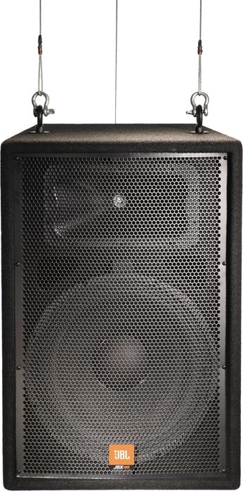

JBL's take on the Unity Horn
There's a bunch of threads on here regarding the Unity horn; it's basically a three-way D'Appolito array, folded around a conical horn, with a coupling chamber inserted to reduce harmonic distortion.
Geddes pioneered the use of reticulated foam in waveguides. In a horn or waveguide, a significant percentage of the radiated sound is delayed in time. This is because a percentage of the sound is reflected off the mouth, and a percentage of the sound does not travel down the center of the horn or waveguide. Those waves are absorbed more than axial waves, as they travel further.
Geddes and Duke LeJeune, from about six years back
Looks like JBL was listening - they've created a loudspeaker which combines a bit from both.
In the three loudspeakers above, the tweeter is at the apex of the horn, just as in a Unity horn. And the midranges flank the tweeter, as in a D'Appolito. But there's a coupling chamber in front of the midrange(s) - just like a Unity. The reticulated foam is used here to good effect, particularly in the line array. Here's quote from the patent:
"The RBI is a substantially solid boundary that is placed over the mid-range speakers to provide smooth, wave-guiding side walls to control the angular radiation of the high-frequency sound waves emanating from the high-frequency sound sources. To allow the mid-range frequency sound waves generated from mid-range sound sources to pass through the RBI, the RBI is designed with openings. To further prevent the possibility of having high-frequency sound radiate through the openings in the RBI, the RBI may be designed with porous material in the openings of the RBI. The porous material would be transparent to the mid-range sound radiation, but would prevent the high-frequency sound radiation from being disturbed by the openings in the RBI."
The graphs show performance with and without the RBI device. (the coupling chamber, like a unity horn.) The difference looks subtle, but keep in mind each segment is TEN dB. Note how the off-axis response is improved, particularly near the crossover point. This is right in the important vocal range, where six dB dips are surely audible!
If anyone would like to learn more, take a look at patent 7134523

The JBL is an interesting design, because an array can control directivity like a waveguide can, except the footprint is much smaller. Then again, waveguides give you finer control, and arguably control directivity better. But combine them both, and you have an excellent compromise. A high frequency waveguide for accurate wave shaping, combined with an array to save space.
A quick comparison of the size is in order:
A Danley SH-50 takes up 11.5 cubic feet. With a 28" mouth, we'd expect to see directivity control down to approximately 482hz.
A JBL VT4886 takes up 1.04 cubic feet(!!!) The waveguide in the center is 7.75" square and we'd expect directivity control down to 1741hz. BUT - the array that flanks the waveguide *also* controls directivity, down to 594hz. My "hunch" is that the polars will show a discontinuity where the waveguide trades off to the array that's wrapped around it.
So let's investigate my 'hunches' and see how the directivity looks...
Here's the directivity of the JBL. As noted above, the array should control directivity down to 594hz, due to the array. And in the graph, we see this is true. (At 594hz, the -6db point in the graph indicates that the loudspeaker has a beamwidth of approximately 140 degrees.) I'd expected an anomaly in the directivity where the waveguide 'trades off' to the array, and we see that anomaly at 800hz.
If I'm not mistaken, there are no published directivity plots of the SH-50. But Paul Spencer has built a very nice horn based off of it. His appears to be about 20" x 20", so we'd expect directivity down to 675hz or so. And in his graph, we see the directivity broadens in the octave from 350 to 700hz, as expected.
I think it's interesting to compare the two designs. The Synergy horn's directivity is inarguably closer to a constant beamwidth. But the size penalty is significant. If size is not a factor, I'd say the Synergy is superior, but the JBL is compelling particularly if you're very low on space. (And since all of my designs are for the home or car, I'm *very* limited on space.)
