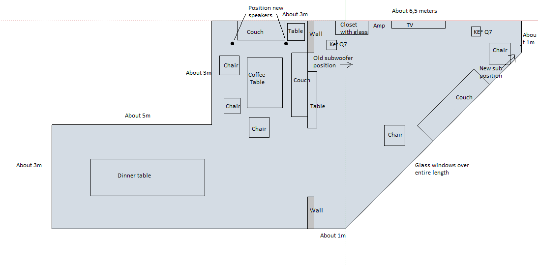

This is a schematic overview of my living room. Middle-left is the sitting area. Right is the movie area and far left is the dining area (which doesn't have to a lot to do with anything).
I've recently changed the position of the subwoofer over to the right, because I feel the sound is better there (also the Peerless XXLS sub still tends to clip at high volumes (making a really load tick...), so I put it closer to the couch (so the volume has to be less) and it doesn't make the closet with glass rattle anymore).
What I could do is place the sub back (another position isn't allowed by the wife of the house) and listen carefully to the bass response. The sub however is aiming towards the right (see arrow) and somehow the bass response on the back of it is a lot less, there is also a big couch in the way of it which seems to dampen the sound.
So as far as it looks I've got two options, either of those with one suboption.
First option is to place the subwoofer back and use it for frequenties below 80 - 100hz. In that case I would need a sealed Alpair 7's or a sealed or small 2-way system.
Second option is not to use the subwoofer and use either vented alpair 7's or vented 2-way system.
Maybe it would also be possible to leave the sub where it is and use it from there. The sound towards the sitting area feels somewhat equal. However, this would mean that the sound is different when you're close to the speakers from when you're further away from the speakers...
What would you think is best?
