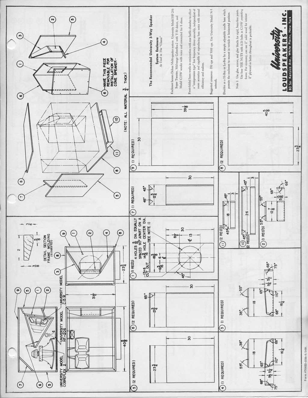

Greetings peoples , I'm 3/4 way thru a University Classic front horn ( singular for mono) build so I'm committed to either the original University 15" driver(cost a fortune in postage) or its proven replacement (the EVM15L according to klipsch forum). I live in Australia and finding these units is proving to be very hard. If anyone can suggest an equivalent driver , esp one that is readily available and has a mass rollof up into the mid 400hz then I'd be most grateful. Below is the plans for the cab, the T&S for the EVM15L driver. Someone has suggested modelling drivers in Hornresp but I'm on Mac and quite frankly it is beyond my level of understanding. How would JBL2220A fare

T&S for EVM15L Fs=43hz ,Vas=0.245m3 , Qts=0.238 , Qms=4.96, Qes=0.25

Interesting! The original had an advertised 25-35 Hz Fs which from now dim memory typically meant closer to 35 Hz plus a strong enough motor to allow for being driven with a high output impedance, but later its Qts was raised as required to account for the decreasing output impedance of advancing amp design technology.
By the time University was absorbed by EV and marketed as the 15W, its specs pretty much mirrored the Klipsch K33, Altec 421 and no doubt other brand/models keen to grab some of the market share.
This would make the EVM's Fs too high and the Lab15's Vas too low for best performance, but it will take reverse engineering the horn to find truly optimum driver specs, so my trip down 'Memory Lane' is anecdotal at best.
Still, it begs the question, has anyone posted about using the K33 and its performance in this horn? Seems like it would be the first to try on the Klipsch forum.
Regardless, assuming I'm right about the probable specs, the 2220 then would require a very high output impedance to get the flattest, widest usable bass BW, but still a little less than with a bona fide C15W in good working condition.

Greetings peoples and thankyou for all the replies, I have a pdf I found on the nt which is a flare analysis of the University Classic and I've been trying to upload it for the last 3 days. Lets see what happens now http://forums.klipsch.com/forums/storage/3/861979/Flare Analysis_Classic.pdf
By gad I think he's done it! Would this make it easier to determine which drivers of a new or readily available nature would be suitable.. cheers fergs

The EV15L has a curvaliniar cone, it has more upper breakup than the 15B.
For horn load, I preferred the 15B, which has a normal conical shape. The conical 15B is cleaner and has more LF, the 15L has more (dirty) top end.
There are several Eminence cones in the Delta and Kappa line up that would perform well in your horn, and may be cheaper than used EV which may have funky cones, or have been reconed with shoddy parts.
Your choice will be more LF or more HF, the cones with more Xmax will perform better down low, the ones with less will be louder up higher.
