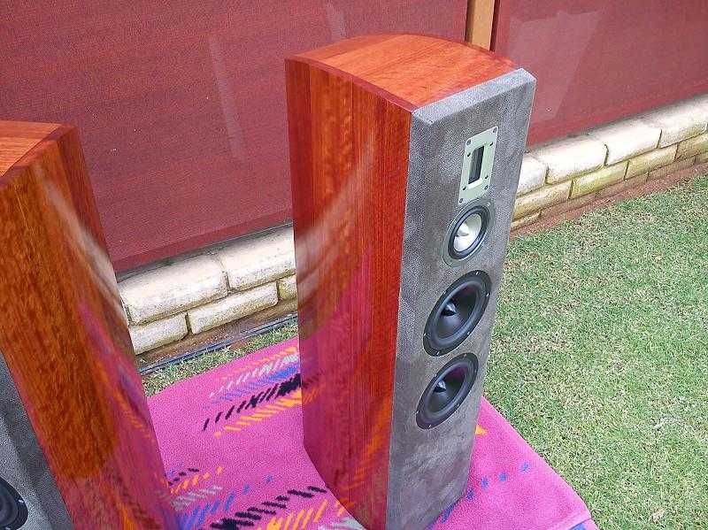

I hope I`m in the the right section to post my tread regarding more info on my speaker building project.
About 12 years back a bought some Blue Gum tree planks that was cut from huge old trees (older then a 100 years according to town folks that know some of their history). The piece of land was bought for the development of an church so some of them were cut down and processed into planks.
At that time I didn't had any plans for them so now 12 years later I decided it was time to use some of them in my speaker project.
Fortunately for me my wife had no objection to the size of the Statement speakers. I however had to modify my home to accommodate the speakers so a few walls had to go (they were kind of a nuisance anyway) coupled with some other alterations.
This was my first speaker project.The build took me about 2 months to complete for the set of five. I worked 95% of the time alone with some occasional help from my wife/twin brother and friends.I spend quite some time in designing and building jigs so that I was able to do most of the work alone. Should I decide to build a second pair it would be much quicker next time.
The Statements way in at 80 kg each (176 pounds) and the Minis are 41 kg (90 pounds) each.
Most of the pic`s were taken wit my cell phones camera so I do apologize for the poor quality in advance.
I also would like to mention that I`m not fluent in English and that some of the words might not have the meaning that I intended.
I`m very proud to show you my Statement family.

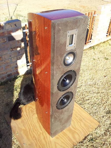

Statements and center.
Click the image to open in full size.

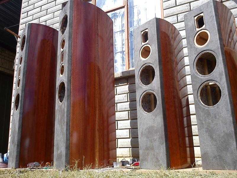

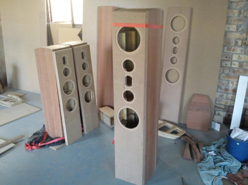

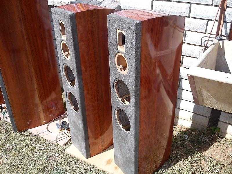

Without drivers

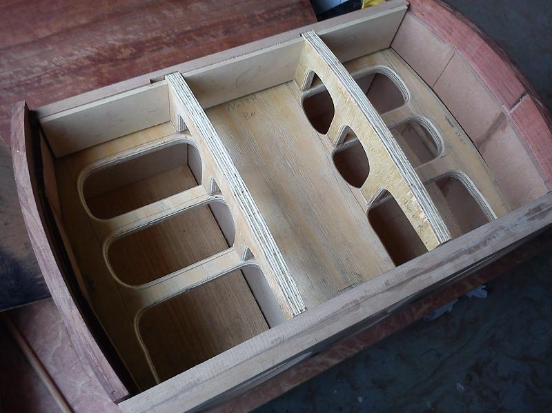

Default more pics

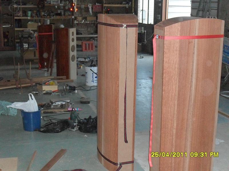

Some more pics in progress.

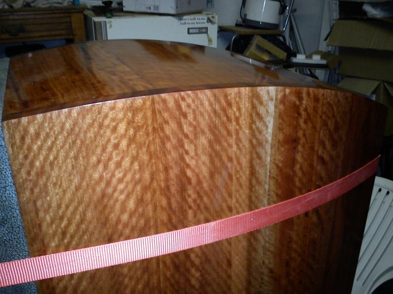

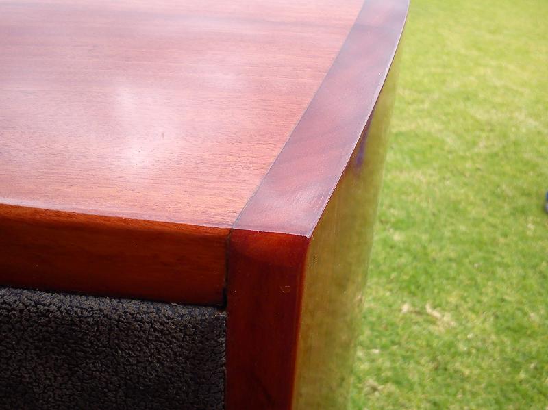

Good picture to get an idea of the design of my Statements.The look that I was after.Curved on the sides and top

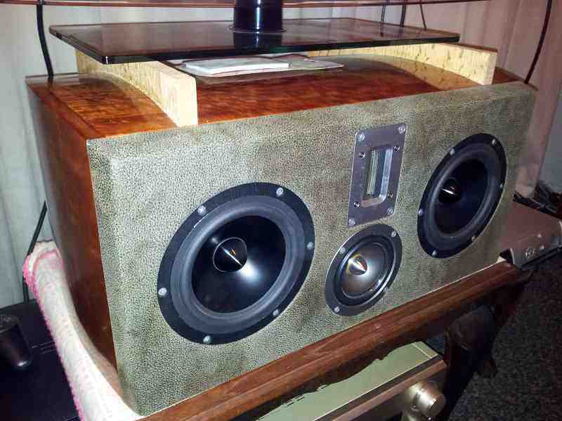

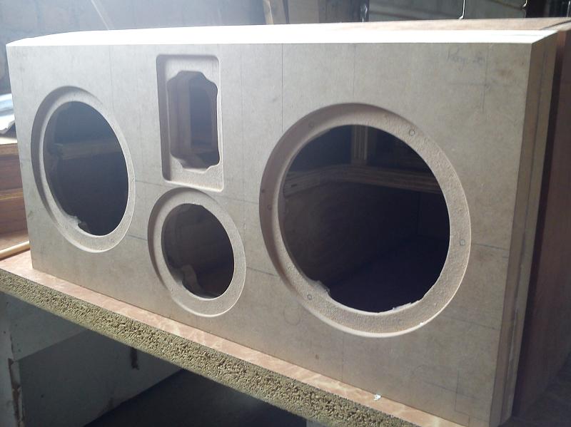

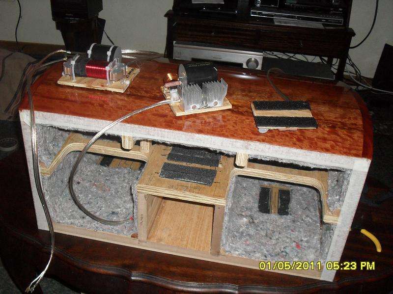

....... and some more pics of the center speaker.
View from top without the front baffle.
crossovers ready for placement.

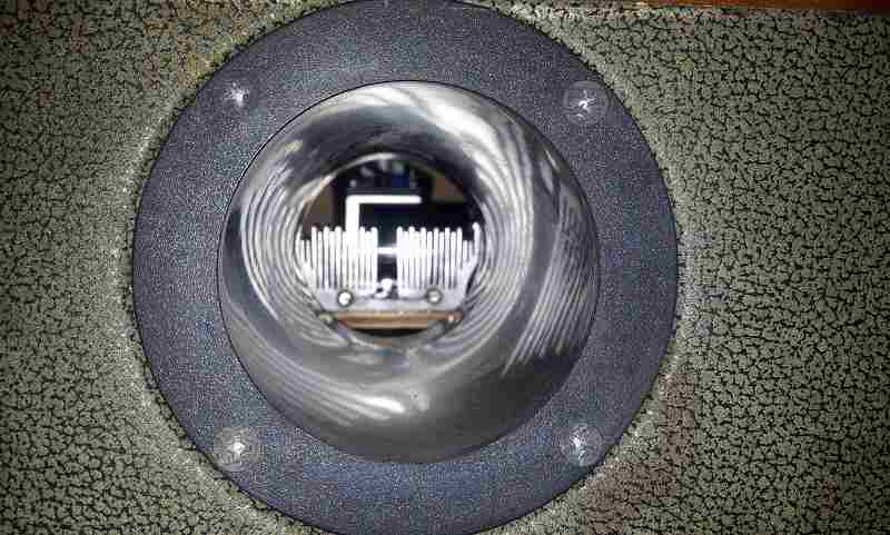

view through back port
Almost finished as I still need to add the feet's that lay on top of the speaker.

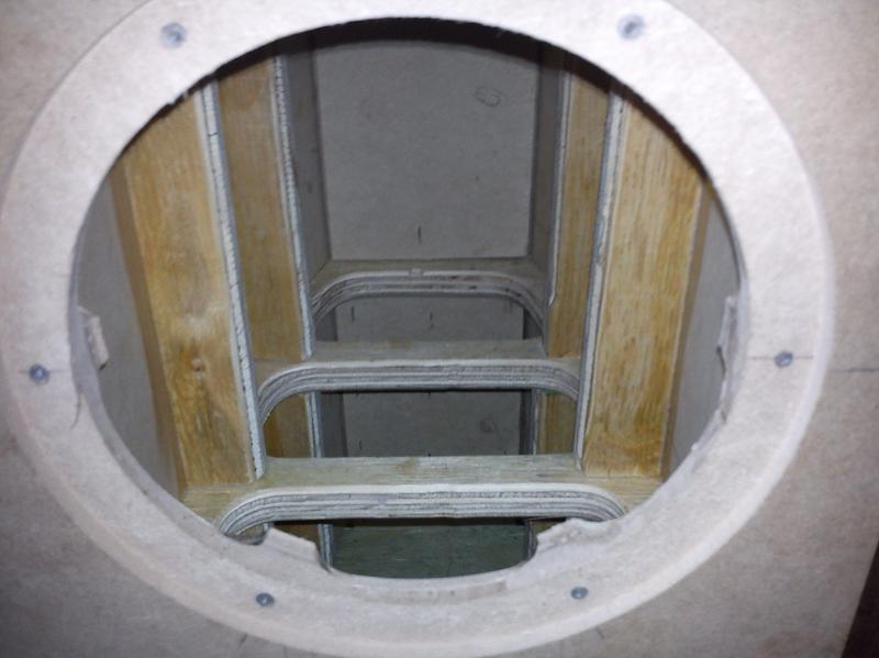

A view trough the Statements lower woofer before damping material.

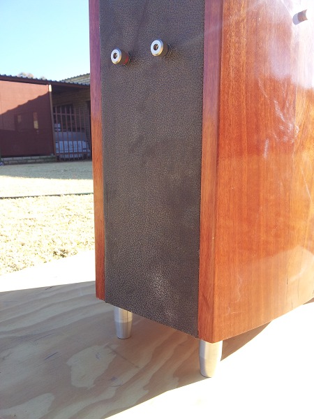

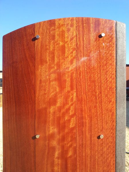

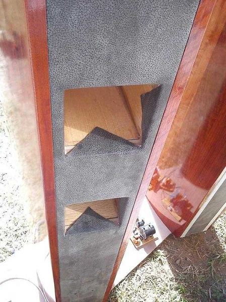

Pic of the feet that a friend made for me that can adjust individually if needed for level placement.
Magnet placement for holding the covers (that I still need to design and make).
I have taken the idea a little further then only on the front of the baffles and added some magnets to the side of each speaker as well to hold the covers in place when I remove them.
The center speakers magnets are on top as I still need to make a dedicated/matching stand/cabinet for the TV and other equipment so the TV on top of the center is only temporarily.
It`s kind of difficult to see the front magnets on this pics.

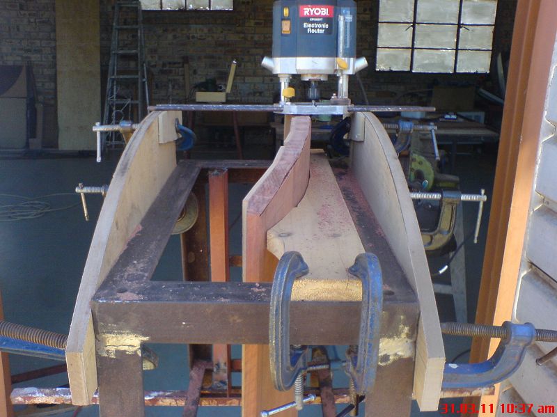

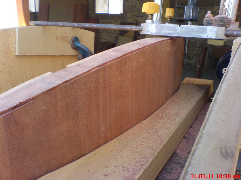

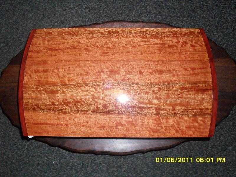

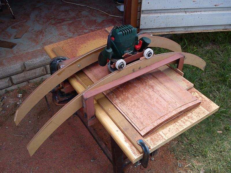

Default making the curves

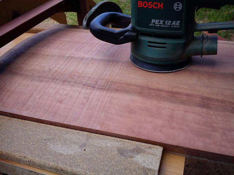

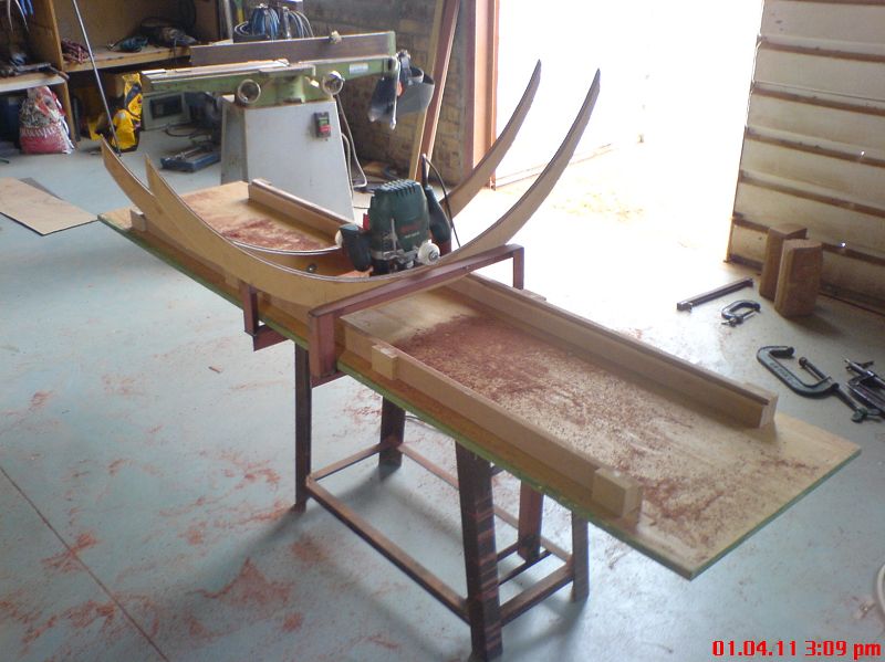

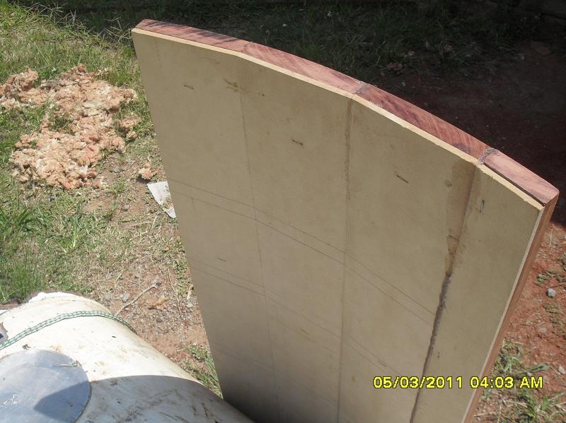

Here are some of the jigs that I made and used. This is what I came up all on my own so I hope to inspire some of you to consider a curved speaker build.
The jigs helped me to achieve the "curved" shape that I had in mind.
Thanks to my uncle for his orbital sander that did a excellent job.
This jig help with the cutting inside the speaker panel/side for the bracings and tops to fit nicely.
  Reply With Quote

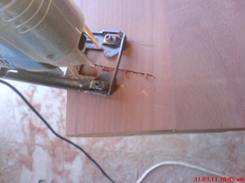

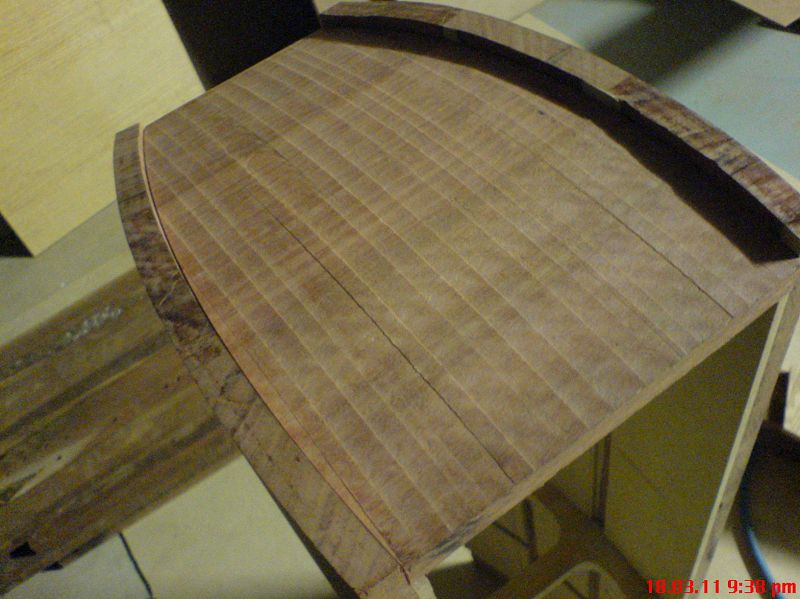

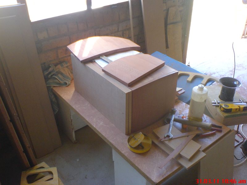

Default Top panel jig

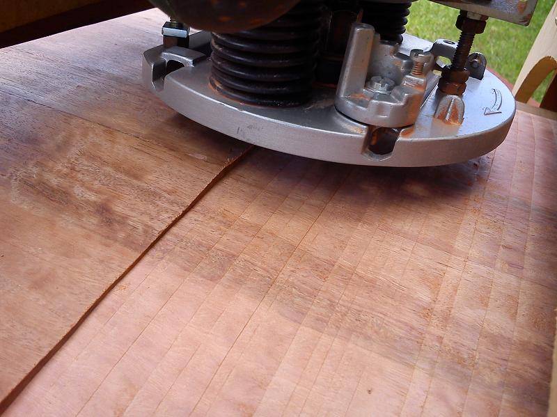

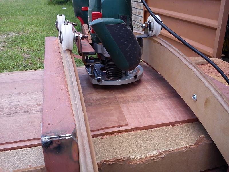

This is how I made my tops and the jig that I used.
I used a jig saw to get close to the shape that I wanted and then I used my router and jig to do it more precise.
One of the MiniStatements tops in progress.

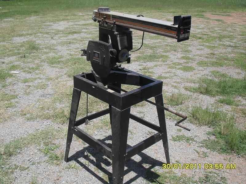

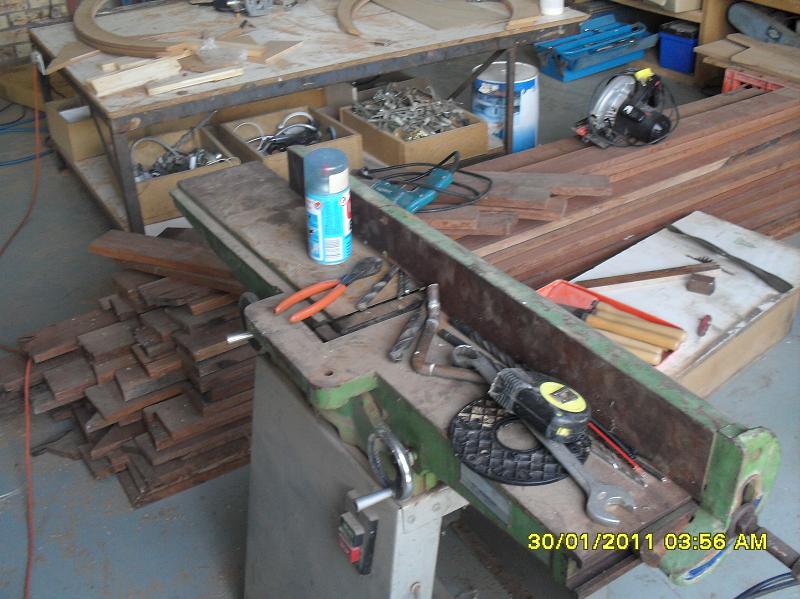

Default Some of the tools that I used
Below is some of the tools that I used. Some of theme are my own and some was lend to my by family members.
My brothers Radial arm saw.

My old wood planer and in the background some of the planks that were going to be used.
