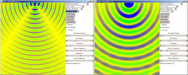

Below is a crude simulation of what this phenomena would look like if say you built a speaker that can color the air in neon green and blue. On the left, 2 point source drivers interact destructively at high frequencies to paint a nice psychedelic blooming neon.. semi-flower? On the right, the same 2 drivers interact well together at low frequencies.

Lobing "is the cancellation that occurs because of distance differential between two drivers."(to the listener)
The frequency of cancellation is one half the distance differential.
Therefore, 1/2 of 60mm equals approx. 11,500 hz or four octaves above the proposed 1400 hz crossover.
While I concede the differential gets large in the vertical off axis beyond +/- 10 degrees (20 degrees), this angle petty much covers the first arrival in most rooms. Unless you are concerned with ceiling and floor reflections.
Can anyone shed some light on this? I guess I am suggesting a 2 wavelength rule as apposed to this post's 1/4 wavelength rule?😕
Two things:
1) Dropping response starts where there is a phase-difference larger than 0 degrees. It would be impossible to maintain this for all frequencies and angles so one must take a practicable value to start with (and which can still be difficult to achieve in practice !).
2) You are off by a factor of four: you should not take half of the distance as wavelength of the frequency in question. You should take the frequency for which the 60 mm are 1/2 of the wavelength. I.e. a frequency with a wavelength of 120mm which is 2800 Hz.

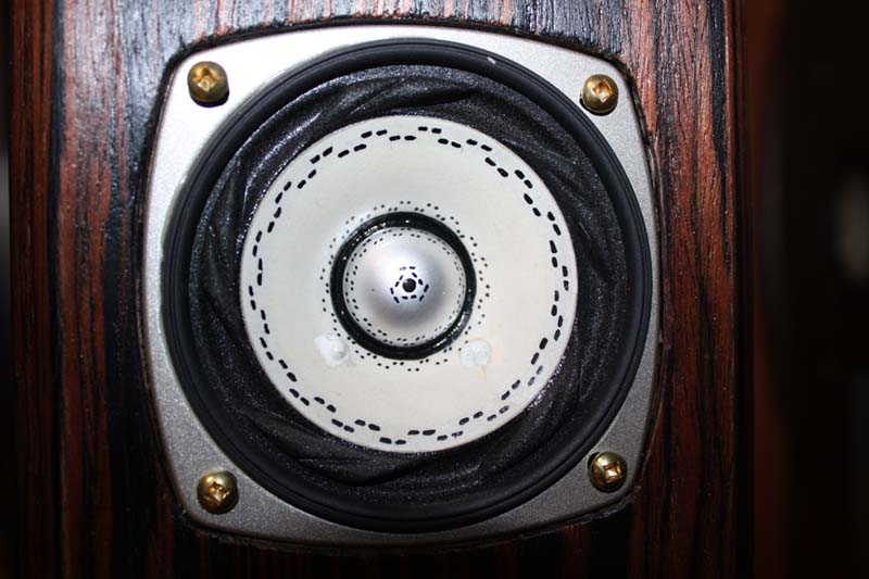

Carefully done, a 3 way with dome midrange eliminates lobing. Here 800Hz and 4kHz crossover. 😀
I wasn't believing what I was seeing when I first simmed the classic Acoustic Research AR-3A and Celestion Ditton 66 3 way loudspeakers. First or second order crossover both work beautifully. Spacing was 20 cm and 10 cm between driver acoustic centres but no baffle time alignment necessary for exemplary phase alignment.
The typical 0.16mH Visaton G50 FFL is a lovely driver:
Visaton - Lautsprecher und Zubehör, Loudspeakers and Accessories
The fact that I was crossing over with low inductance drivers below troublesome frequencies made the filters easy. At crossover the drivers both maintained good dispersion too. You can see a case for a supertweeter here. This simply doesn't work so well with a 5" cone midrange driver because its acoustic centre is further back than with a dome and its dispersion is poorer.
