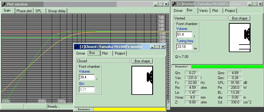

Somewhere I found Thiele/Small parameters for the bass driver that suggested that it would be suitable for bass reflex. I believe that keeping the same width dimensions and the same driver placement (relative tot he top edge) there'd be no need for reworking the crossover with this mod.
This is from WinISD:
Click the image to open in full size.
