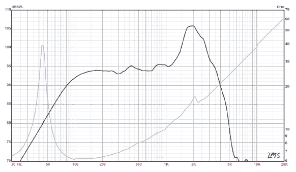

alpha 15" won't be a good driver for the bass. it's goes down like a rock after 100 hz. so a beta maybe. any ideeas about the shape oh the baffle?
I believe the SPL curve was generated with the Alpha 15A in an enclosure, I seem to remember reading this in the fine print of an Alpha 15A spec sheet. The curve is totally inconsistent with the manufacturer's specs, mine and other's measured specs, simulation results using the measured specs, and listening impressions in real systems. On the right baffle it extends flat to 40 Hz or in an H frame to about 30 Hz. The manufacturer's SPL curve has caused a lot of confusion and is really not accurate for the driver.
