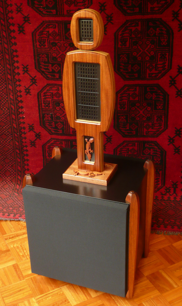

Sorry I fell asleep on the job, they are 98% finished and are playing as they are. I still have to make some wire covers for the speaker terminal connections on the actual mid & tweeter drivers & hopefully take some better photos when my brother brings his camera over.
The front is the side without the screws that where necessary to hold the men together.
I would like to thank everybody that has helped in this long long build, especially Helmuth for all of the advice in the early stages, 56 for all of his encouragement, Andy for getting the screws I wanted & shipping them to Australia, my brother for making the lizards & generally getting in the way😀 only kidding and everybody else who has either encouraged me and or given advice, the list is long.
If you look at the first page & then the last you will get a good idea of the journey.
Thanks again
