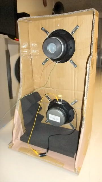

OK, I'm cheating, I own the drivers already (stored for a while). So only the baffle was built, and this part is REALLY CHEAP 😀 I own the Amp 6 kit and the related parts for mod, too..
Basic setup is 2 x 8" widerangers per side and sort of 1.5-way -- the one on top plays fullrange and the bottom one joins somewhere below midbass. I tried series xover here -- just connecting a cap across the one for bass (short-circuit when frequency is higher then a point... ), and connect the 2 drivers in series.

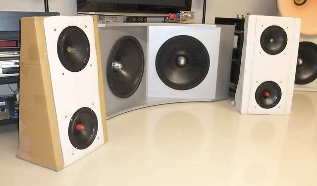

Ah! this is much better:
(note: the big woofers in V-shape baffle in the background are not included in this system)
LoL !! yes! cardboard baffles 😀 How can you beat that in cost! And they are even not in pair -- not the same color and even different in size. Guess I care ? 😀
Minimalism construction - partially destructed cardboard box, some glue and duct tape, done!

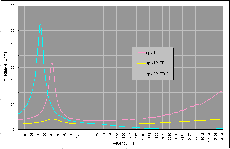

This is the first time I try series xover. As mentioned above, I want high impedance towards LF, to work with high Zo amp. Since the impedance peak at fs is always there and can't be removed, especially in barely loaded dipole, so I'd like make use of it. Passive series xover configured in 1.5way makes the amp see two drivers in series, thus double the impedance (well, sort of). This enhances the interaction with high Zo amp in the way I want.
The R1 in parallel with upper driver is for attenuating it somewhat by sharing the current, and also reducing the overall impedance in this section, which attenuates it further. But too small of it would suck out the liveliness of the mid-high sound. Also a lower series R makes the lower cap bigger to maintain the proper low pass frequency for the lower driver. Howerver, too big a cap sucks too much current, makes the mid-bass weak. By the size of baffle (only 40 cm by 70cm, with some side wings as the picture), I was planning the join-in frequency of the lower driver in 150~200 Hz range. Eventually I couldn't get the target because of those dilemmas.
Dilemmas, all over🙁
The numbers above are the final compromise among drivers' characters, baffle size, sound quality... etc. By the way, I always feel a passive xover with severely padded down section(s) sounds dull. Resistors in series with drivers give zero good impression -- just a necessary evil, to maintain a proper balance. Now I find it almost equally annoying when using it in parallel.
How about ditch the resistor? I tried it but there's another problem. Two sections in series, then the one with higher impedance shares more voltage, thus more power. Since the dipole loss are huge in LF, so I need as much power as possible here, at least in a view of proportion.
Now these 2 drivers are not the same. Sigh~ but these are what I got on hand right now. The impedance measurements reveal a horrible fact that the one on top has a higher fs (but lower impedance peak). So you can see two peaks in the chart:
I can not get overlapped display on WT3's screen, so I exported the data and made a chart with separate driver's curves:
Here you can see, in the midbass range, how the upper one suck much more voltage than the lower one by its much higher imedance. However this driver has inherently lower sensitivity, higher fs and much dryer/thinner bass by ear, so it's a bad choise for the bass. Dilemma again.
This is another major reason of the parallel R - to damp the impedance peak and let the lower one get the larger share of the available voltage.
Tried and tried, I settled to 10R and 100uF, now the system impedance curve looks pretty much as I hope for.
