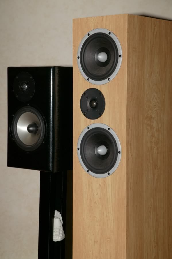

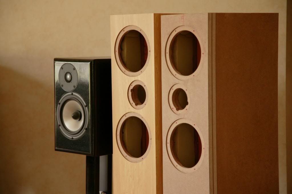

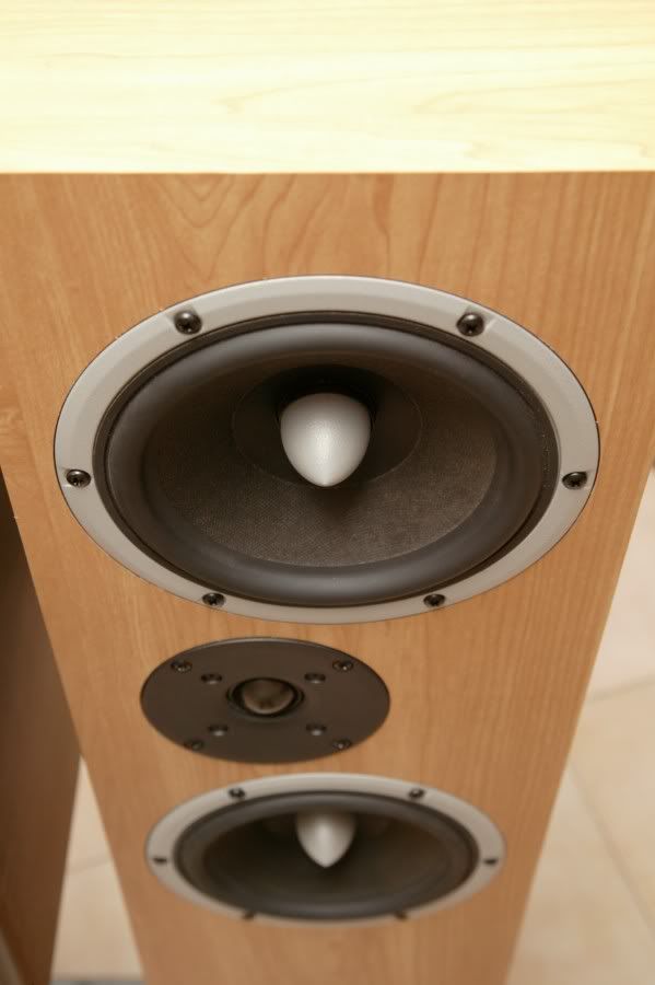

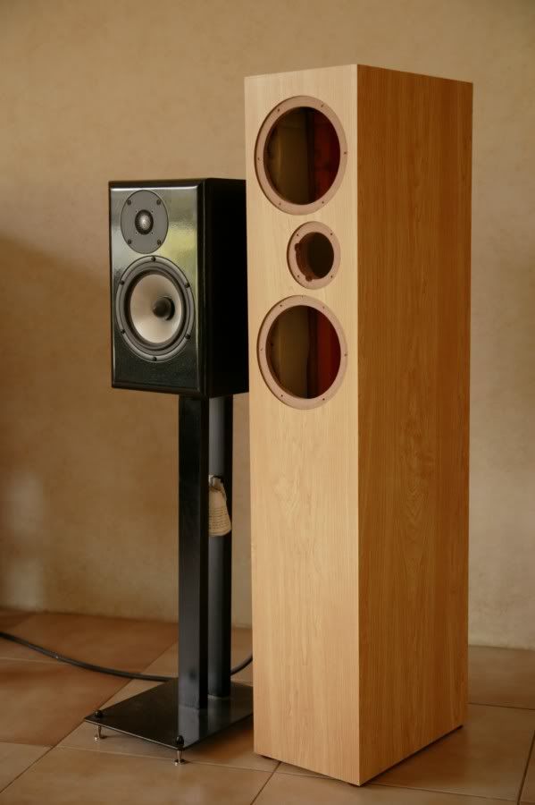

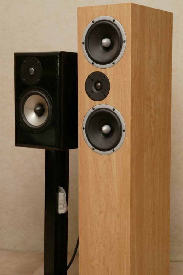

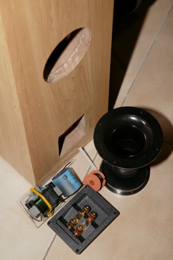

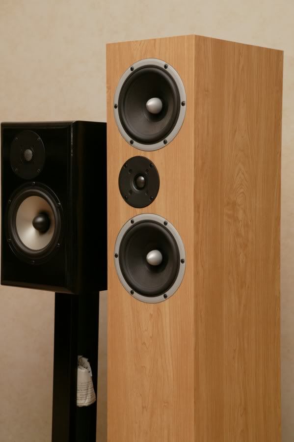

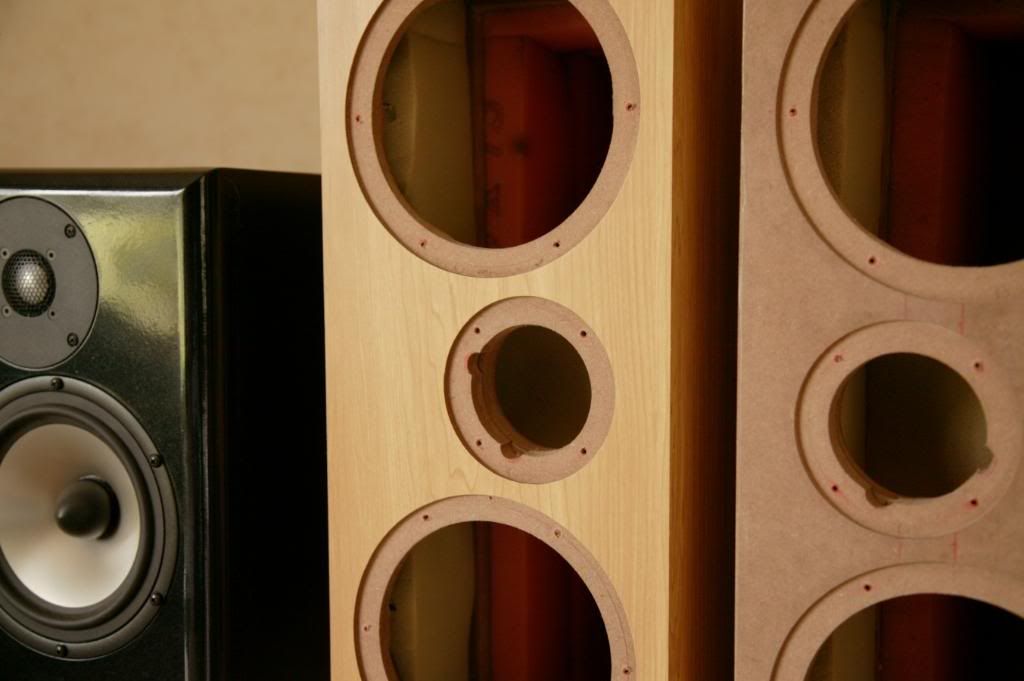

I would like to share with you my latest speaker.
Actually, The drivers I'm using with these are from my old 2 and a half way floor standers, I decided to make it a 2 way MTM, because I was not totally happy about my old one having thick sounding midbass due to the full bsc it had.
Wow!
That's an excellent example of someone taking a simple design, and making it look good.
How do they sound?

Thanks 🙂

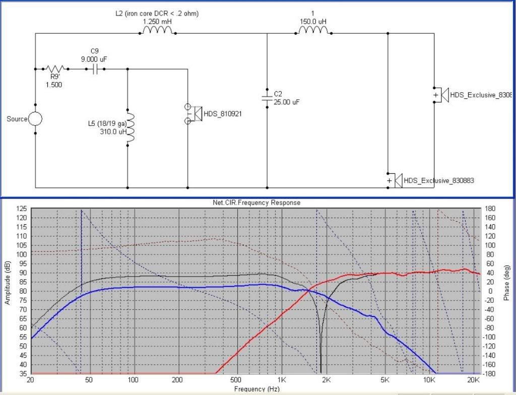

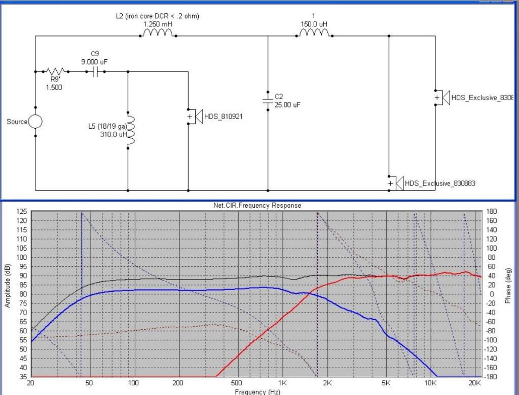

But I'm afraid to say that I have not yet listened to them, As I lack some crossover parts , Which I should be receiving next week.
But I'm sure that this would sound better than my old 2.5 way, As it decreased the bsc in computer simulation. And having been familiar with the sonic characteristics of these driver, I could imagine that the Xo design would be close to actual sound, And would only need minor adjustment in the tweeter resistors.
I have design the XO to be as simple as possible, The shallow dip around 1,300hz is not XO related, It is the response of the drivers.
