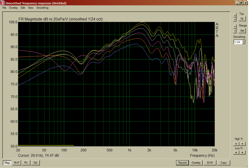

A bit of history first.
My first dipole was in 2007. In the beginning I thought the most difficult part was the bass. Turns out that the midrange EQ is not easy.
But then after understanding the midrange, it's actually the transition to tweeters that is problematic. The normal approach of back-to-back tweeters is a love-hate relationship. I couldn't decide whether it's actually better than single tweeter. At one stage I was considering to try waveguides/horns (shiver..)
After following closely (and quietly 😀) the above threads I built this prototype today:
"Tweeters" are 3" TangBand Fullrange.
... and what a beautiful polar response (un-eq for now)! Very consistent response up to 10khz. I haven't seen polar plot of well-known dipole speakers but this would be almost impossible to produce using typical back-to-back dome tweeters.
And so cheap too! Next is to build the EQ 😎
What is surprising for me is how easy it was to set tweeter level. Just measure flat from 1m and I cycled through my music. All sounded well. Tweeter setting using back-to-back Dipole used to be very frustrating.

That looks like a small version of Bud Purvine's rocketship OB... except he is planning a lowther up top.
You have me inspired to go read the threads you've linked.

Yes, I followed BudP's plan as well. However the size of that Lowther may not allow good polar response near the last octaves. For a 6" perhaps up to 2 or 3 khz. Lower if the diameter is bigger.
What I want is a great 2" fullrange as this would extend further. I do not really need the low Fs (60Hz) of 3" speaker. I have aura nsw2 which works great with Pluto but the rear cavity presented problems as dipole.

Gainphile,
I really don't want to spoil the party, but what you show is not (yet) what the contributors mentioned above are trying to achieve IMHO. 😱
You have got nice constant directivity up to 1 kHz, but above 3 kHz it is simply a beaming 3" TangBand. Between 1-2 kHz I see an intermittent beaming which I would relate to a less than optimal depth alignment of both drivers for that area - but I'm not sure of that.
Radiation to the back of the speaker will be VERY different from the forward too.
If you really want to follow the 'CD throughout' path you need to reconsider those "typical back-to-back dome tweeters", but changing to really tiny tweeters - or the Neo3.

Looks good, gainphile! I agree that a 2" with a small rear structure might be ideal. The dipole D would be smaller than either the Neo3 or any back to back setup I've seen.

Rudolf does have a point though - the driver is beaming. Even the SL's Plutos beam, and I feel it is audible, and they use a 1" driver. Something interesting though - SL addressed that in his 2.1 revision - compare the transfer functions. The original Pluto has a flat on axis response, but the later version has a rising response at higher frequencies. I would wager this it to help even the power response due to the tweeters beaming, and I bet it is a nice improvement.

The xo is at 2.4khz, so the irregularity 1-2khz is due to the midrange being pushed quite high. As I can cross the TB very low I will see whether crossing at 1khz will fix this issue.
With dipoles, we actually need to 'utilise' the beaming properties of drivers above dipole peak. So the frequency before the dipole dip is perfectly usable. Of course we can use the "pure" CD section that is possible too, but will be very expensive in terms of the number of drivers used.
I did measure the rear radiation, and it is different, but still very smooth to high octaves.

Gainphile,The xo is at 2.4khz, so the irregularity 1-2khz is due to the midrange being pushed quite high. As I can cross the TB very low I will see whether crossing at 1khz will fix this issue.
the rear radiation of the TB looks really good from 2-5 kHz and partly up to 8 kHz. 🙂 Got my interest. Could you give the exact type?
If you can get both drivers to integrate even better at 1-2 kHz , regarding front & rear, your combination should have a nice polar response indeed. And surely it avoids that tinkering with tiny tweeters. 😉
Not good ...
First of all to reply to Rudolf, the TB is W3-1364SA. They got small neo magnet and hence great rear opening which may explain the pretty-good rear response.
Now, about the system. After a longer listening sessions I found they don't sound as realistic as the previous (normal mid + dual domes on normal baffle). Obviously the FR driver do not have resolution and cleanliness of the dome tweeters. But more serious is how the whole presentation seems 'disconnected'. Not coherent. I feel like it's due to the transition between 19cm baffle to no baffle but can't really put my finger on it.
After even longer listening (to make sure this is just something to get used to) I reverted back to the original build, and they definitely sound more believable. Even the soundstage seems to reach deeper.
So unfortunately I had not make any progress.
