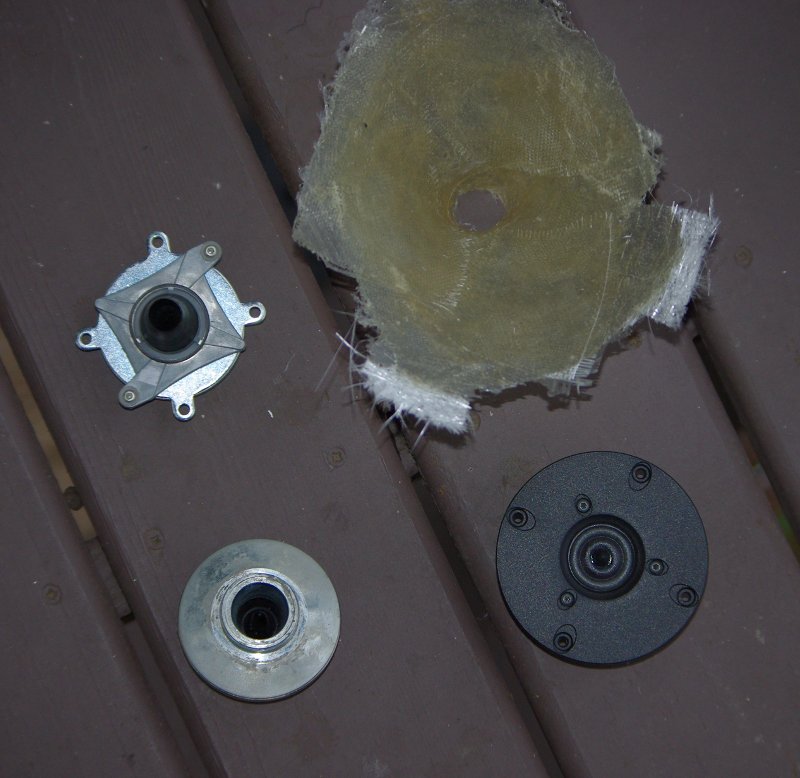

Here's where things get interesting! If you take the Celestion apart, you basically have a high efficiency dome tweeter with a very nice phase plug. It's difficult to tell in these pictures, but that's a 1.75" dome with a sophisticated phase plug mounted in front.
There are a number of other benefits as well. Brandon's measurements showed that the Celestion has lower distortion than the BMS. This is likely due to the larger diaphragm of the Celestion. Also, this waveguide design "pushes" the soundstage back by three or four inches.
This seems like an ideal solution. We reduce the depth of the waveguide, the overall size, and we still have very high efficiency. As a bonus, it *might* reduce high-order-modes. (Based on my understanding of HOMs, they're created by diffraction. By using a waveguide angle that is unchanging, we reduce diffraction. WIN-WIN.)
Over the weekend I hacked up the Celestion compression driver, and did various measurements. I also measured a direct radiator on a waveguide. In this post I'll cover the following:

The first device that I tested uses a Peerless 830970 in a *very* shallow waveguide. I'm basically using it as a tweeter. The pics above are from my car. The device that I measured used a single Peerless woofer on a flat baffle, with a 1" roundover to reduce diffraction. The waveguide size is identical - about 3" wide and 3/4" deep.
The reason that I opted for this model instead of a conventional tweeter is that the larger diaphragm creates a narrower beam of sound than a conventional tweeter. The pic above is the published polar response, from Peerless. As a rule of thumb, loudspeakers beging to beam at wavelength that's equivalent to the piston's diameter. For the 830970, that means it will start to beam at 6750hz. But can we use a waveguide to control directivity down to two or three khz?
Here's the polar response of my reference, a set of Gedlee Summas. I measure on the same scale as Geddes, but my measurements are in 15 degree increments, his are in 7.5. We're both measuring from zero to ninety degrees. Note that I'm not trying to achieve flat response, I'm trying to achieve directivity control. So I don't care that the response is falling; that can be fixed electronically. Directivity can only be manipulated physically.
Theoretically, a waveguide that's 3" wide and 3/4" deep should control directivity down to 4500hz, with a beamwidth of ninety degrees. It appears that the Peerless waveguide performs a bit *better* than expected. The graph above shows a beamwidth of ninety degrees all the way down to 3khz! By 10khz the beam has narrowed to sixty degrees, which should reduce reflections even further. There's a dip at 16khz, which is also present in the literature from Peerless. This may be reduced via the use of a phase plug perhaps. All in all, I believe this is exceptionally good performance, particularly since the device costs less than ten dollars, including the woofer!
- Pros - very VERY inexpensive, small, easy to build, exceptionally good directivity considering the size.
- Cons - very low power handling, not as efficient as a compression driver, there's a dip at 16khz
