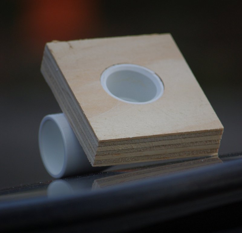

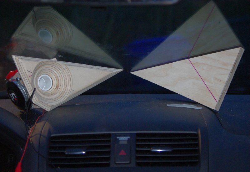

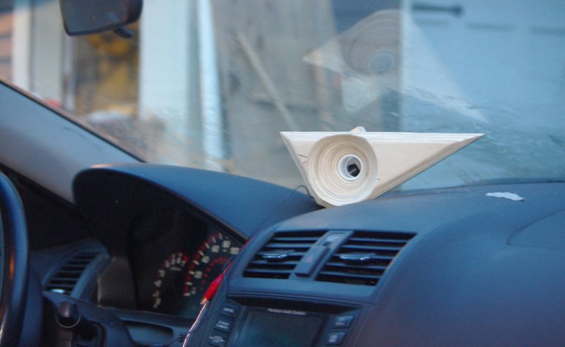

While messing around with a center channel this week, I accidentally created the most realistic soundstage I've ever heard in a car. Considering that I've been studying this subject for the better part of twenty years, I thought some others might enjoy reading about what I did, and some further experiments to improve things.
A lot of my previous work on the subject is over on diymobileaudio.com. However, the more that I work with car stereo, the more I realize that the tricks we use in the car can be used at the home and office.
For instance, I sit in front of a computer for 8-12 hours every day, and the work day would be a lot more enjoyable with a high quality stereo. Many of the tricks featured in this thread will also work in very small rooms, for instance a home office or a computer gaming room.
What I am going to explore in this thread is using psychoacoustic tricks to fool the listener into believing that they hear speakers which aren't there.
Click the image to open in full size.
We've all seen these HDTV soundbars, which attempt to recreate a five-channel experience using as many as a hundred speakers in a single enclosure. The way that the good ones work is that they create a beam of sound which is focused at specific locations in the room, creating reflections which fool the listener into believing there are speakers there (which don't exist.)
Here's the thing though - they suffer from distortion, due to the small size of the drivers, and their goals are quite ambitious - five channels from one enclosure.
What I am going to document in this thread is the use of a single enclosure to cover stereo high frequencies, using waveguides to control the beam, and compression drivers to lower distortion down to inaudible levels.
If my engineering goes according to plan, we'll have two virtual speakers which seem to emanate from the left and the right.

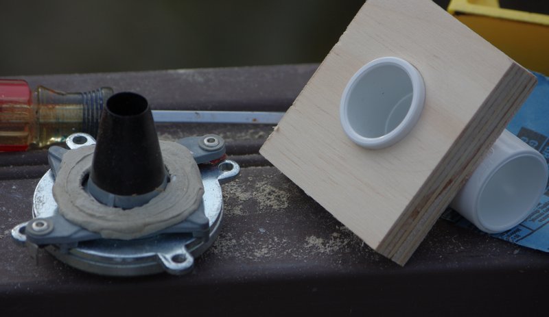

I am getting very good results with a Peerless 830970. I'm feeding it about four times as much power as it's supposed to get, and it's taking it like a champ. Then again, I have it crossed over at 3khz, so that helps
While it's marketed as a woofer, due to it's very small size, it's makes a compelling tweeter. It has a copper cap and an underhung motor. So if you use it down to 200hz, it's distortion performance is good considering it's size. But if you limit it to high frequencies only, you're basically looking at a tweeter that can run with the big boys that cost $50 and up.
As a bonus, it's smaller than 80% of the tweeters out there, and it has enough excursion to be used with very shallow slopes.
I am also using it dipole, as I've found that dipole tweeters sound very 'open'.

I tried ambiophonics in the past, and found that the processing sounded unnatural and distracting. As you know, it's possible to do the same thing with a physical barrier.
In this thread I'll be doing something similar. But instead of a physical barrier, I will use a waveguide to narrow the response of the high frequency drivers.
Theoretically, this should give us the best of all worlds:
  • Using a wall to eliminate crosstalk is effective, but it looks ridiculous
  • Using DSP to eliminate crosstalk *should* work, but sounds unnatural to me. It also reduces dynamic range.
  • A carefully designed waveguide can limit radiation even more effectively than a physical barrier.
Stay tuned...
