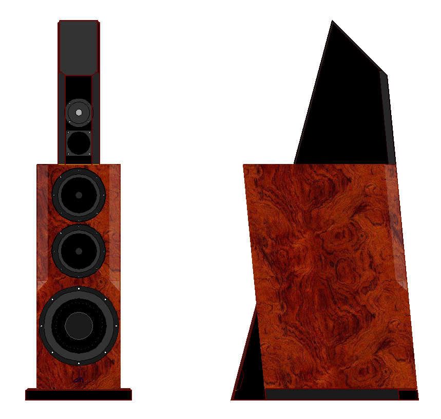

I think there is something to the narrow versus wide baffle in terms of imaging quality. It has been my observation (subjective as it is) that narrower baffles do image better and that as a baffle gets wider (at least in the midrange and tweeter area), it eventually becomes easier to audibly locate the speaker in the room (point to its location with you eyes closed).
These two observations have led me to the design I'm working on now. It uses somewhat progressively narrower baffles as you go from the low frequency driver, to the woofers, midrange and tweeter. It is a 4way (SWWMT) with a 10" sub and active crossover at around 100hz on an 11" wide baffle (no chamfer). The WWMT portion of the speaker will be passive. Two 7" woofers are on an 11" wide baffle with 1" chamfers, crossing over to a 2" mid dome at about 1000hz on a 5.5" baffle with 1" chamfers, that crosses to a 3/4" dome tweeter at around 3500hz also on the same 5.5" baffle with 1" chamfers.
The depth of the boxes are designed to reduce the amount of the sound does not wrap around the baffle and the sides and radiate back toward the front wall. This should do away with front wall reflections about 600hz or so and up, allowing for the speaker to be placed closer to the wall than typical, yet provide excellent soundstage width and imaging (hopefully). Also, the intent of the narrower baffle is to try and push the diffraction dips up into the drivers stop band, where possible, in an attempt to reduce the its impact.
This design is being done with drivers I already have on hand. The sub driver is a 10" Dayton Reference Series RSS265HF in a tapered transmission line with an F3 of around 25hz or so and an F6 of around 19hz. With room and boundary gain, it should be pretty flat to 20hz or so. The woofers are Dayton RS180's (in a sealed box). The midrange is the Morel MDM55 and the tweeter is the Seas 22TAFG. I'm calling them "The Blades" due their resemblance to a utility knife.
Below is what the design concept looks like:
Attractive looking speakers, Dan.
If I may make a suggestion, it would be smart to model your design in LEAP or another ap that can predict each driver's power response around the crossover points. At 1kHz, transitioning from an 11" baffle loading your midbass at roughly 2pi to a 5.5" baffle loading the midrange at roughly 4pi means you could have significant ripple in the power response. Definitely something worth checking, IMO.
Also, at 1kHz, the 1" chamfer on your midbass baffle would be purely cosmetic (it's only about a tenth of a wavelength), but still worth keeping because it does look good.

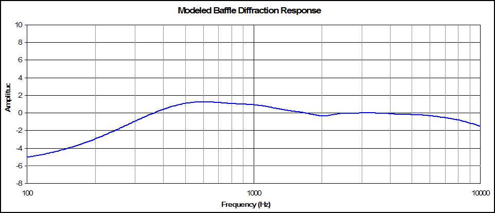

I'm a SoundEasy user and this is all prior to any crossover modeling. I will be building a prototype to do actual measurements from. The top MT section will remain removable in case there are issues the require a design alteration. For example, I could step the baffle width further by addding additional width in the midrange area and step back again in the tweeter area. This is just the first steps in the process.
What I have modeled so far is baffle diffraction, also combined with room and boundary gain modeling and TL modeling using MJK's mathcad worksheets. The 1" chamfer on the 11" baffle does do make some difference in terms of reducing the diffraction peak and dip, thus flattening the response, but I doubt it would be audible, especially since the diffraction ripple is up around 1500hz, IIRC.
Actually, let me post a couple of the model results (see below), since they are somewhat germain to the discussion of baffle width. The first two are the bottom 7" woofer with the chamfer followed by the bottom woofer without chamfer. Below that are the top 7" woofer with the chamfer, followed by top woofer without chamfer. Below that are the midrange and tweeter diffraction models. I also have models for each driver that combine diffraction, room gain and boundary gain in the intended room and speaker position as well.
