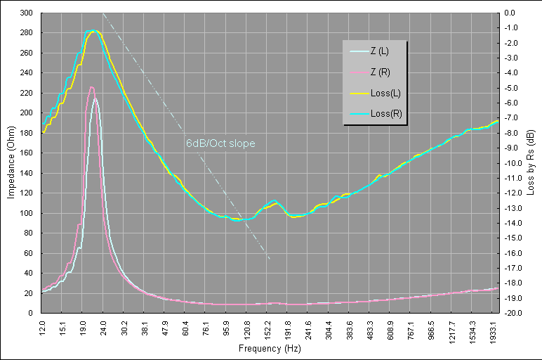

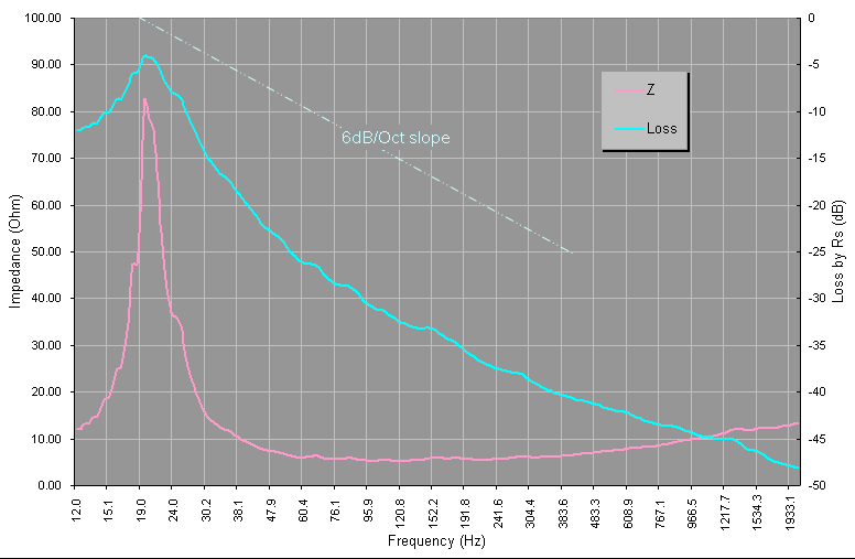

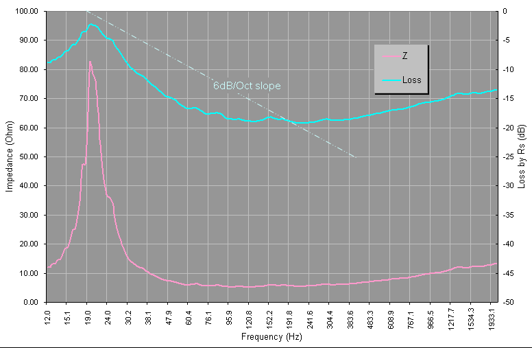

I made some spreadsheets and charts for visualizing the effects. The driver's (system's) impedance data were exported from the measurements by WT3. Then I added series R (output impedance, Zo) to simulate the 'loss' along the combo of this fixed series R and the measured impedance curves.
This is the current setting with 20 Ohm Zo, by calculation, system Q=1.1, and the deepest loss between 20Hz and MB is 10dB.
The real in room response needs extra 3dB or so to fulfill my taste, so maybe I'll increase the Zo to 32 Ohm, system Q=1.5, and the max loss comes to 12.5 ~ 12.7 dB, then it'll look like this:
(a mysterious peak around 160Hz, appeared after the mod of phase plug... )

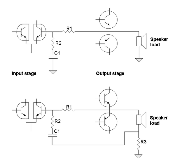

For those who are not familiar with SS amp circuits (like me), here I show you how I did the mods. We don't need to deal with the entire amp, only focus on the feedback circuit is enough (for this topic only, of course 😉 )
Here is a highly simplified circuit diagram of a typical SS amp (the upper one):
Trace it out from the output stage would be easier (components and copper traces are larger and simpler). You could find out a small resistor connected between output point (bus) and one leg of a tiny transistor. (Probably much nearer than you'd expect) At the same point it connects to the tiny transistor, there'd be another small resistor in series with a cap (mostly a low voltage 100uF electrolyte) and then to ground. These are the R1, R2, and C1 shown above.
Then according to the Figure 2 of this article:
Variable Amplifier Impedance
The following actions should be easy. Now the grounding point of the cap should be connected to the resistor in series with the load (R3 as shown above in the lower diagram) The calculation according to the article above is quite straight forward and you'll get the proper values of all the components by that simple equation.
Since the R2 might be changed, so you may also need to change the C1 accordingly to maintain a proper time constant.
Don't forget to re-adjust the EQ and damping of the system if any.
Have fun 😀

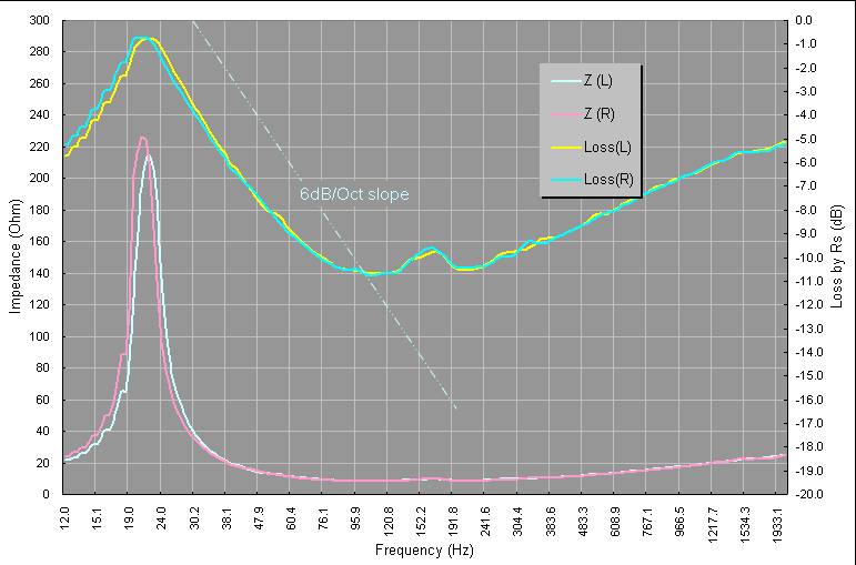

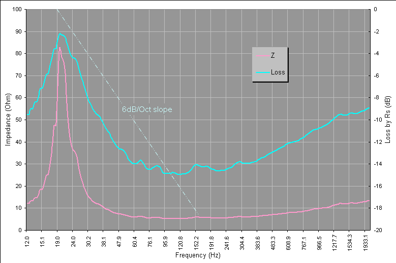

I made some spreadsheets and charts to visualize the effects of inductor as current feedback element:
This is the previously mentioned choke with 2.6 mH, 0.16 Ohm DCR in the position of "R3":
(note that the scale is very different from the ones I posted previously)
The output impedance is changing with frequency and quite high. It's 35.94 Ohm @ 12Hz, rising up with frequency, and skyrocketing to 3395 Ohm @ 2kHz. (I didn't calculate those above... )
And the following is adding a 0.5 Ohm in parallel with that choke:
With the damping resistor, the Zo of amp is changing not so severely. 21 Ohm @ 12Hz to 50 Ohm @ 2kHz. (Seems a good compromise... )
The inductance is less dominating when the parallel resistor get smaller. I can't figure out the sweet spot now, just fiddling with these numbers...
