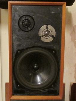

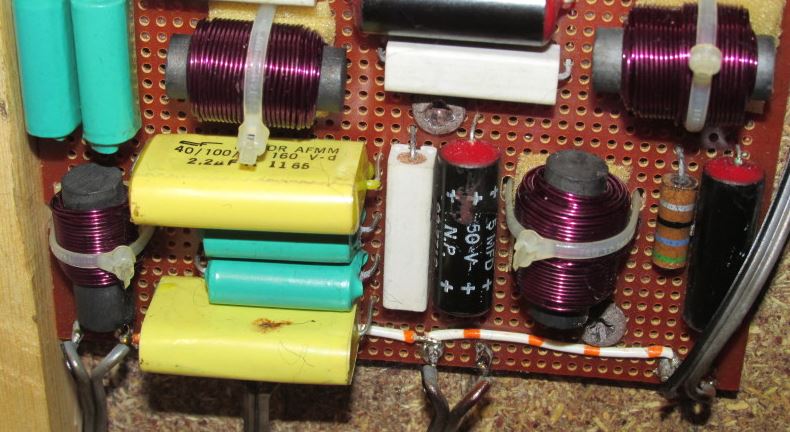

A fun find by charlie2 for a mere £33! 🙂
A three way 1980's kit monitor from Wilmslow Audio who are still going strong.
It's a Spendor BC1 clone, by the look of it.
KEF B200 bextrene cone, the Celestion HF1300 compression driver coming in around 1.5kHz, and a Coles supertweeter above 7kHz. Three ways avoided 25% luxury purchase tax, being considered professional.
Very much in the vogue, back in the day, and extremely good for classical music.
