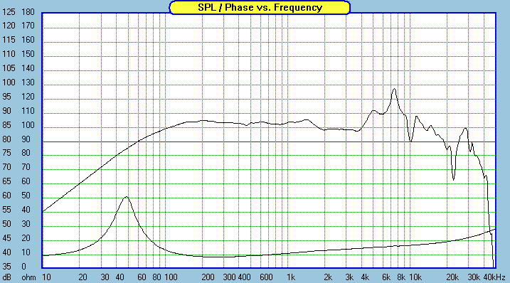

I bought Fountek FW168 midbass drivers and Seas 27TBFCG tweeters to build 2-way speakers.
I haven't measured the midbass, but think Zaph has measured it's response well. (I've already listened it without enclosure.)
Can I use Zaph's L18/27TBFCG crossover (http://zaphaudio.com/audio-speaker17.html) because of the similarity of the two aluminum cone midbass drivers (FW168 & L18)? (I think it would work, and just have to finetune the tweeter L-pad later.)
Click the image to open in full size.

Their frequency response is very similar. Can I use the Zaph's L18 crossover with the same tweeter (27TBFCG)?
Fountek FW168
Seas L18
  Reply With Quote
