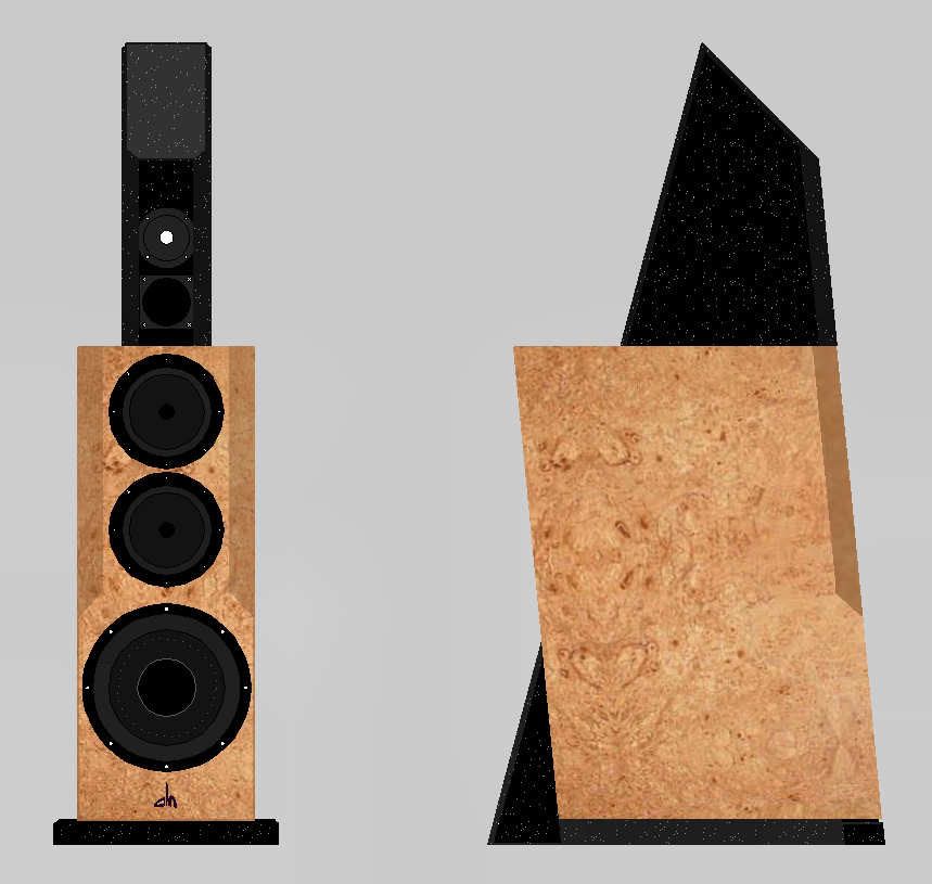

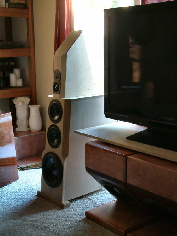

I call these the BaSSlines. They were inspired by a pair of speakers I heard last year designed by Jeff Bagby and Jim Salk of Salk Sound (hence the BaSS in the name). They are a 3way using a 12" Lambda TD12H in a 52 liter, slot ported cabinet (F3 around 35hz) with an open baffle B&C 6md38 6.5" midrange and a Peerless HDS tweeter mounted in a shallow waveguide. The sensitivity is probably around 92db.
I hope to have the finish wrapped up in the next week or two and then will make final crossover tweaks, if any, and publish the completed design. I used a small spare room we have upstairs to do the finishing in, since it is easier than doing out in the garage this time of year. I etched the logo on the Lexan with by hand with a dremel using vinyl stencils (that John over at AE speakers did for me, thanks John!) as a guideline.
There is a more complete build thread here:The BaSSlines
Thanks for looking.

wow... great looking speakers... great color,theme and good use of mixed mediums...
how do they sound

Thanks.
I'm thrilled with how they sound. IMHO, they are my best work so far and are up there with the best I recall hearing at DIY events over the last few years. Wide and deep soundstage, very clean and dynamic and forgiving of all kinds of material.
