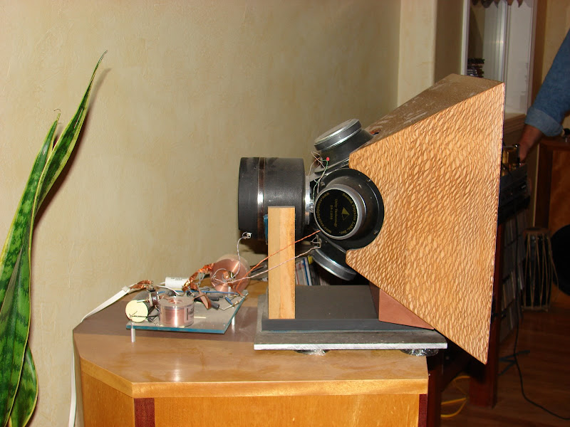

Here's some pics I took of the 'real' Unities (these are the ones from Lambda Acoustics.)
Click the image to open in full size.
My ever-tolerant girlfriend
Some audio nerd
Surprisingly small
A detail of the midrange holes. Very important!
TAD compression drivers!

Patrick, do those midrange holes create impedance/frequency response bumps at certain frequency?
  Reply With Quote
Old 4th February 2009, 03:28 PM   #5
diyAudio Member
Patrick Bateman's Avatar
Join Date: Oct 2006
Quote:
The midrange drivers on the Unity are coupled to the horn by a throat, just as in a conventional horn. The difference is that the horn is not driven at it's apex.
So the "holes" are actually the throat of the compression chamber of the midrange drivers.
Here's a diagram of a conventional horn. Shift the drivers a couple of inches down the horn and you get the general idea.
