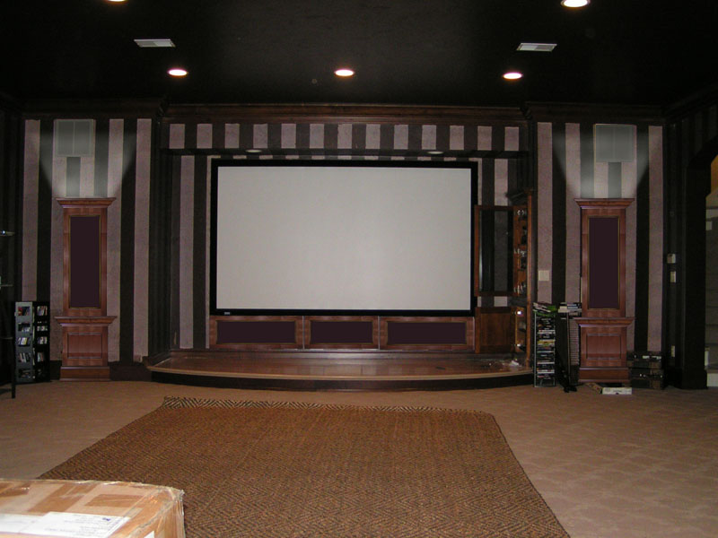

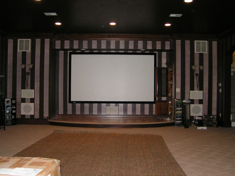

As far as dream theater setups go, I'm actually getting the chance to make one of mine a reality for someone right now. I never have the time or money to do anything nice for myself.
Each of the front 3 channels consists of a pair of the TD10M's, one of our new 6.5" drivers, and the RAAL 140-15 ribbon tweeter. These are really the elite of all drivers for the application. While there are other options that can play louder than the RAAL ribbon, it will still play plenty loud and there are few options that can match the detail and clarity. He has a whole rack of QSC and Crest amplifiers from a previous installation along with 2 dBX driverack 260's for processing. The front 3 channels will all be 3 way active. The subwoofer will consist of 8 of the IB15's taking advantage of a large storage room behind the 12ft wide screen. With the VLF gain in the room, we can expect to see levels upwards of 120dB down as low as 10hz.
Here is the current room as is. The stripes you see on the walls aren't really there. There are flat and semigloss burgundy stripes. Very subtle but in the pictures they really stand out:
Click the image to open in full size.
Here is the proposal I made with photoshop showing the 2 planned columns with lighting coming out from the top of the columns. There are 2 columns already on the right hand side of the room as it opens to a bar area, so the front columns match the room well.
