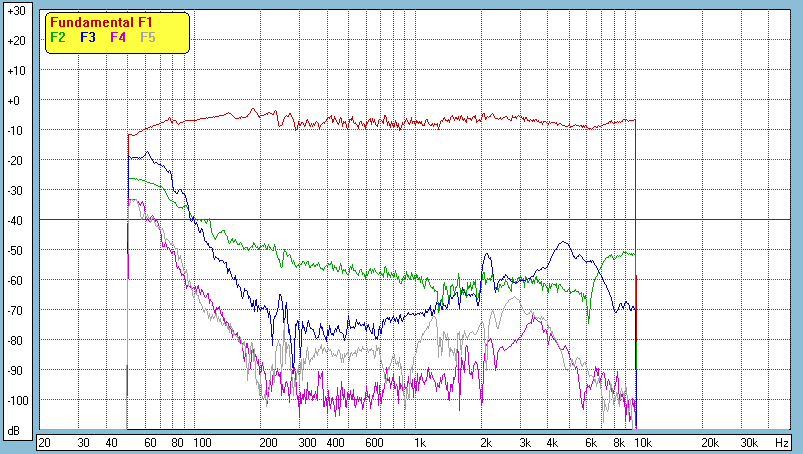

Jesus. Being wrong is also non productive.
The Dayton RS100S-8 is in reality given Sd a 3" driver.
Vas of 0.7 cuft / 20L ? ludicrous for a 3" driver with an Fs of 85hz.
PE state the Vas to be 0.07 cuft = 2L, Zaph measured 1.4L.
3" drivers do not do 36Hz and the bass alignment you showed is horrible.
It does show that you used 0.07 cuft for Vas though, not 0.7 ....
Like I said a 2L Vas driver in a 11L box is just so wrong .....
/sreten.

Quote:
Zaph
Dayton RS100S-8
Cost: $26
Usability:4.5/5
Build Quality:5/5
Consistency:not rated
Value: 4.5/5
Comments: This is a great performing 3" driver. The frame is a very nice casting with better than average ventilation. Very smooth, wideband response. Copper appears to be used in the right place in this motor, for very low distortion and no inductive rise. Could be used full range with a breakup notch and a shelving BSC filter, but would be even better paired with a cheap neo tweeter.
The cost is not that low for a 3" driver, but considering the performance, value is still very high.
Tested March 2008.
Sd is similar to TB and Aura 3"ers. Basically it has a big flange.
Click the image to open in full size.
Fighting a losing battle trying to go under 100Hz.
After applying BSC fairly crippling sensitivity too.
/sreten.
