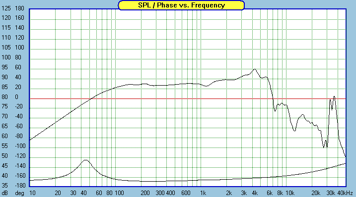

Good suggestion, sreten. Yeah, using a Zobel like RC can be a way to suppress an upper mid bump in an LP response. Actually, I tried it for this design. But in this particular case, a little more complicated network worked much better. If the bump were at 900 Hz to 1 kHz, the RC would work, though.
I used Zaph's measurement:
http://www.zaphaudio.com/6.5test/830883-FR.gif
Pretty much the same as the first one you posted (more recent one posted at Tymphany site). Good consistency, here.
The hump in my sim is also due to a diffraction hump from a 8.5" wide baffle I used for this sim. Attached is my simulated in-box response of the 830883. A problem with an RC approach is that it also suppresses the 1.2 kHz dip greatly. A high Q, dampened notch at 800 Hz suppresses the hump but doesn't affect the 1.2 kHz dip since it helps to form an LP rolloff with a bit high Q "knee."
-jAy

The 27TDFC's high 3rd order harmonic distortions, excited by an input signal at 6 kHz, will be generated at 18 kHz. You won't be able to hear this effect. When you see a tweeter's distortion measurement, you need to focus between 1 kHz and 4 kHz since responses in this range form the defining characteristic of the tweeter.
Can you email me for the sw file? I can work on this xover on these weekends.
