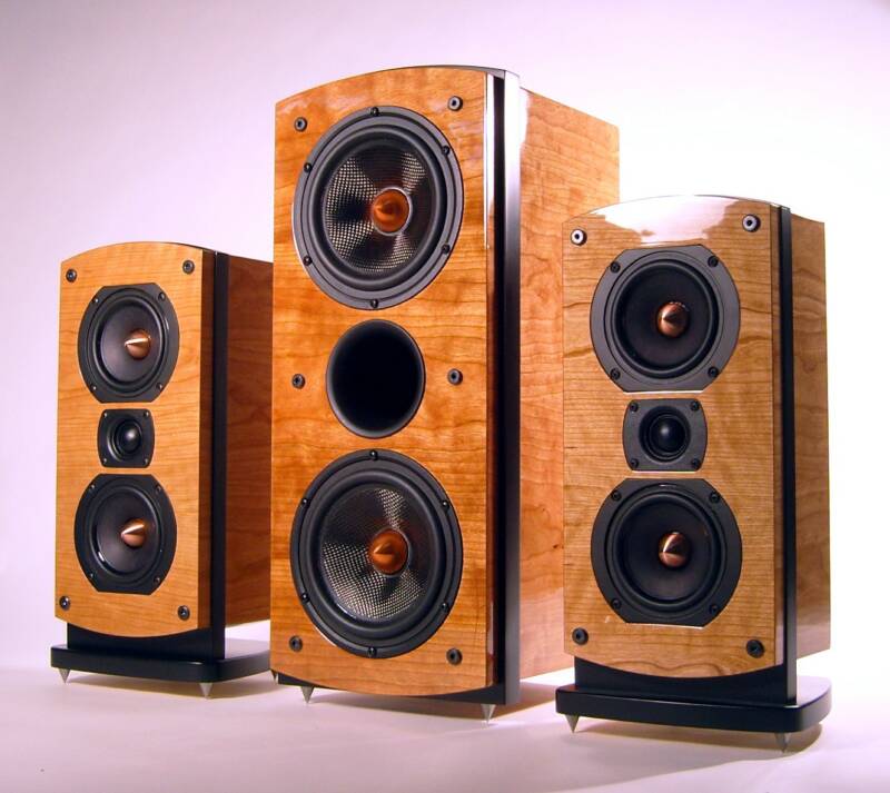

Something like this might look nicer.
You can do all sorts of wonderful things with MDF and nice cherry veneer, as shown above. ;)
