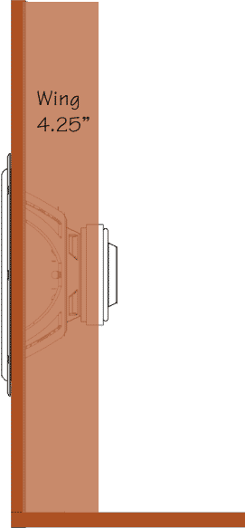

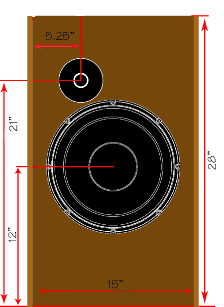

First the baffles:
They are 15” wide by 27” tall. Chipboard, MDF, plywood etc. will do just fine. Mirror image tweeter placement for left and right.
Some sound deadening (simple automotive spray) should be put on the baffle back. Typically they sound balanced with the baffle face being from 30" - 38" from the rear wall and at least 36" from side walls. Only about 83 dB sensitivity at 1 kHz and -3 typically from around 40 Hz to 22 kHz on axis up to 14' of listening distance. You will want to elevate the baffle off the floor with a target height for the tweeter of 42", depending on your listening position.

The side wings of the baffle are asymmetrical to help smooth frequency response. Tweeter placement is also chosen for smooth response and to mate well with the woofer. Note that left and right baffles should be mirror images. The tweeters will be toward the inside edge when the speakers are in their playing position.
There are refinements that can be made to the basic design without much trouble. The drivers can be flush mounted, if you have the tools and the skill. Flush mounting should help refine the midrange. Baffle edges could be rounded over, which should also smooth out the mids, but maybe at the expense of a little bass response. And of course the crossover could be tweaked, but it will take a lot of experimentation or experience to get it better.
